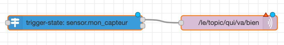

Ca, par exemple:
[{"id":"b7fc690.b6ce198","type":"trigger-state","z":"d59703d6.87ebf","name":"","server":"d28c9492.f419c8","exposeToHomeAssistant":false,"haConfig":[{"property":"name","value":""},{"property":"icon","value":""}],"entityid":"sensor.mon_capteur","entityidfiltertype":"exact","debugenabled":false,"constraints":[{"targetType":"this_entity","targetValue":"","propertyType":"current_state","comparatorType":"is","comparatorValueDatatype":"str","comparatorValue":"","propertyValue":"new_state.state"}],"outputs":2,"customoutputs":[],"outputinitially":false,"state_type":"str","x":260,"y":4220,"wires":[["6c0ad32d.315ccc"],[]]},{"id":"6c0ad32d.315ccc","type":"mqtt out","z":"d59703d6.87ebf","name":"","topic":"/le/topic/qui/va/bien","qos":"","retain":"","respTopic":"","contentType":"","userProps":"","correl":"","expiry":"","broker":"","x":580,"y":4220,"wires":[]},{"id":"d28c9492.f419c8","type":"server","name":"hassio","legacy":false,"addon":false,"rejectUnauthorizedCerts":false,"ha_boolean":"y|yes|true|on|home|open","connectionDelay":true,"cacheJson":true}]
Le noeud trigger est activé sur changement de valeur du sensor. La valeur est dans msg.payload et il suffit d’appeler le noeud mqtt out

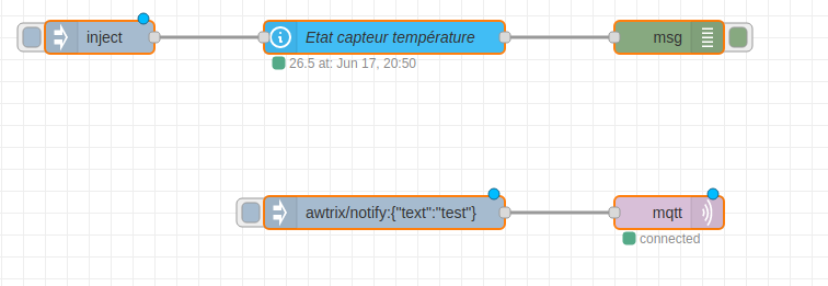

voici ce que je fais
[{"id":"6fe46aa7.9dc1ec","type":"api-current-state","z":"fb49e400.b7da2","name":"Etat capteur température","server":"4e801e3f.b30a6","version":2,"outputs":1,"halt_if":"","halt_if_type":"str","halt_if_compare":"is","entity_id":"sensor.temperature_158d0002451bf6","state_type":"str","blockInputOverrides":false,"outputProperties":[{"property":"payload","propertyType":"msg","value":"","valueType":"entityState"}],"override_topic":false,"state_location":"payload","override_payload":"msg","entity_location":"data","override_data":"msg","x":430,"y":240,"wires":[["2995d3a4.40181c"]]},{"id":"272839bb.1043ee","type":"inject","z":"fb49e400.b7da2","name":"","props":[],"repeat":"","crontab":"","once":false,"onceDelay":0.1,"topic":"","x":170,"y":240,"wires":[["6fe46aa7.9dc1ec"]]},{"id":"2995d3a4.40181c","type":"debug","z":"fb49e400.b7da2","name":"","active":true,"tosidebar":true,"console":false,"tostatus":false,"complete":"true","targetType":"full","statusVal":"","statusType":"auto","x":690,"y":240,"wires":[]},{"id":"93852e84.e88e98","type":"inject","z":"fb49e400.b7da2","name":"","props":[{"p":"topic","vt":"str"},{"p":"payload"}],"repeat":"","crontab":"","once":false,"onceDelay":0.1,"topic":"awtrix/notify","payload":"{\"text\":\"test\"}","payloadType":"str","x":430,"y":400,"wires":[["5b5c8bd0.3170e4"]]},{"id":"5b5c8bd0.3170e4","type":"mqtt out","z":"fb49e400.b7da2","name":"","topic":"","qos":"","retain":"","respTopic":"","contentType":"","userProps":"","correl":"","expiry":"","broker":"18e0e9d5.2c8936","x":690,"y":400,"wires":[]},{"id":"4e801e3f.b30a6","type":"server","name":"Home Assistant","version":1,"addon":true,"rejectUnauthorizedCerts":true,"ha_boolean":"y|yes|true|on|home|open","connectionDelay":true,"cacheJson":true},{"id":"18e0e9d5.2c8936","type":"mqtt-broker","name":"","broker":"192.168.0.12","port":"1883","clientid":"","usetls":false,"protocolVersion":"4","keepalive":"60","cleansession":true,"birthTopic":"","birthQos":"0","birthPayload":"","birthMsg":{},"closeTopic":"","closeQos":"0","closePayload":"","closeMsg":{},"willTopic":"","willQos":"0","willPayload":"","willMsg":{},"sessionExpiry":""}]
Dans le premier j’envoie l’état du capteur vers un node debug, j’obtient :
Dans le second je formatte :
  • un msg.payload : {« text »:« test »}
  • un msg.topic : awtrix/notify
    vers un node MQTT out et le message test s’affiche sur awtrix
Ce que je n’arrive pas à faire c’est à partir du node currentState générer un msg.payload du type : {« text »:" entity state"} où entity state est la valeur du capteur.
Je pense que je tourne autour, que cela doit être évident, mais je sèche :disappointed:
