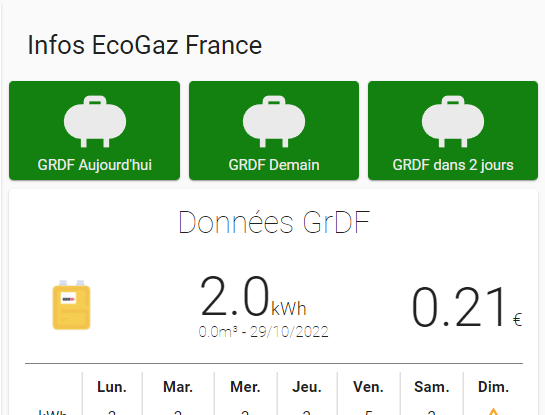

Bjr, est-ce que tu peux partager code / carte ? Merci
EDIT: plus nécessaire… je ne savais pas le lovelace gazpar carte existe

type: horizontal-stack
  - type: custom:button-card
    color_type: card
    entity: sensor.ecogaz_level_today
    name: ENGIE maintenant
    state:
      - value: Green
        color: green
        icon: mdi:fire
      - value: Orange
        color: orange
        icon: mdi:fire
      - value: Red
        color: red
        icon: mdi:fire
    styles: null
    card:
      - font-size: 15px
      - font-weight: bold
    color_type: card
    entity: sensor.ecogaz_level_tomorrow
    state:
      - value: Green
        color: green
        icon: mdi:fire
      - value: Orange
        color: orange
        icon: mdi:fire
      - value: Red
        color: red
        icon: mdi:fire
    styles: null
    card:
      - font-size: 15px
      - font-weight: bold
    color_type: card
    entity: sensor.ecogaz_level_in_2_days
    name: ENGIE dans 2 jours
    state:
      - value: Green
        color: green
        icon: mdi:fire
      - value: Orange
        color: orange
        icon: mdi:fire
      - value: Red
        color: red
        icon: mdi:fire
    styles: null
    card:
      - font-size: 15px
      - font-weight: bold
title: Infos EcoGaz
