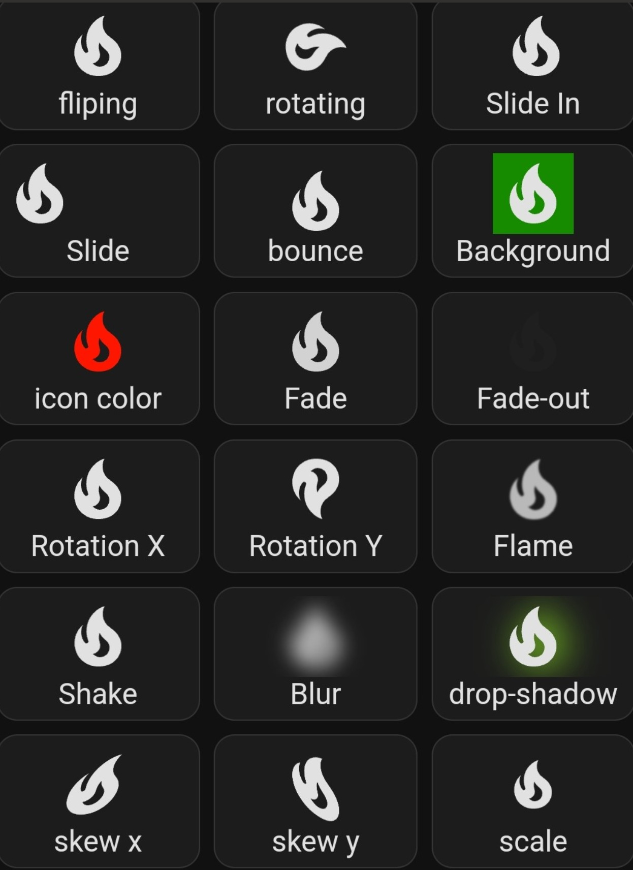

Hello @Galadan
Je ne réponds pas vraiment avec cette carte mais j’avais trouvé cet exemple il y a qque temps que j’ai conservé pour le cazou ^^
type: grid
- type: custom:button-card
icon: mdi:fire
styles:
icon:
- animation: flip 1s infinite
extra_styles: |
@keyframes flip {
0% {transform: scaleX(1)}
49.99% {transform: scaleX(1)}
50% {transform: scaleX(-1)}
99.99% {transform: scaleX(-1)}
100% {transform: scaleX(-1)}
icon: mdi:fire
styles:
icon:
- animation:
- rotating 3s infinite alternate
icon: mdi:fire
styles:
card:
- height: 100%
icon:
- animation: slidein 3s infinite
extra_styles: |
@keyframes slidein {
from { margin-left: 150%;}
to { margin-left:0%;}
icon: mdi:fire
styles:
icon:
- animation: slide 3s infinite
extra_styles: |
@keyframes slide {
from { margin-left: 50%;}
icon: mdi:fire
show_entity_picture: true
styles:
icon:
- animation: bounce 3s ease infinite
extra_styles: |
@keyframes bounce{
from {top: 0%;}
50% {top: 100%;}
to {top: 0%;}
icon: mdi:fire
styles:
icon:
- animation: background 3s infinite
extra_styles: |
@keyframes background {
from {background-color: red;}
50% {background-color: yellow;}
to {background-color: green;}
icon: mdi:fire
styles:
icon:
- animation: icon-color 3s infinite
extra_styles: |
@keyframes icon-color {
from {color: red;}
50% {color: yellow;}
to {color: red;}
icon: mdi:fire
styles:
icon:
- animation: fade-out 3s infinite
extra_styles: |
@keyframes fade-out {
0% { opacity:1; }
50% { opacity:0; }
100% { opacity:1; }
icon: mdi:fire
styles:
icon:
extra_styles: |
from { opacity:1; }
to { opacity:0; }
icon: mdi:fire
styles:
icon:
- color: var(--state-icon-active-color)
- animation: rotation_x 5s infinite
extra_styles: |
@keyframes rotation_x{
0% {transform: scalex(-1)}
50% {transform: scalex(1)}
100% {transform: scalex(-1)}
icon: mdi:fire
styles:
icon:
- animation: rotation_y 5s infinite
extra_styles: |
@keyframes rotation_y{
from {transform: scaley(1)}
50% {transform: scaley(-1)}
to {transform: scaley(1)}
icon: mdi:fire
styles:
icon:
- animation: flame 1.5s infinite
extra_styles: |
@keyframes flame {
0% {filter: blur(0px);transform: translate3d(0%, 0, 0); opacity:1; }
50% {filter: blur(1px) ;transform: rotate(2deg) translate3d(1%, 0, 0); opacity:.60; }
100% {filter: blur(0px);transform: rotate(-1deg) translate3d(0%, 1%, 0); opacity:1;}
icon: mdi:fire
styles:
icon:
- animation: shake 0.82s infinite
- transform: translate3d(0, 0, 0)
extra_styles: |
@keyframes shake {
10%, 90% {
transform: translate3d(-1%, 0, 0);
20%, 80% {
transform: translate3d(2%, 0, 0);
30%, 50%, 70% {
transform: translate3d(-4%, 0, 0);
40%, 60% {
transform: translate3d(4%, 0, 0);
icon: mdi:fire
styles:
icon:
- animation: blur 5s infinite
extra_styles: |
@keyframes blur {
0% { filter: blur(0px);}
50% { filter: blur(6px);}
100% { filter: blur(0px);}
icon: mdi:fire
styles:
icon:
- animation: drop-shadow 5s infinite alternate
extra_styles: |
@keyframes drop-shadow {
from { filter: drop-shadow(1.95rem 0 0 pink);}
to { filter: drop-shadow(0 0 0.95rem chartreuse);}
icon: mdi:fire
styles:
icon:
- animation: skewX 5s infinite alternate
extra_styles: |
@keyframes skewX {
from { transform: skewX(50deg);}
to { transform: skewX(-50deg);}
icon: mdi:fire
styles:
icon:
- animation: skewY 5s infinite alternate
extra_styles: |
@keyframes skewY {
from { transform: skewY(0deg);}
to { transform: skewY(-180deg);}
icon: mdi:fire
styles:
icon:
- animation: scale 5s infinite alternate
extra_styles: |
@keyframes scale {
from { transform: scale(0);}
to { transform: scale(1);}
square: false
Tu devrais y trouver ton bonheur ?

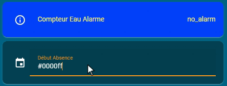

Je cherche désespérément à utiliser un input pour une couleur de fond d’une carte mais sans succès.
Mon code est :
card_mod:
style: |-
ha-card {
color: yellow;
background-color: "{{ states('input_text.coul_fond_porte') }}"
Je souhaite utiliser dans une variable des couleurs au format RGB mais que ce soit en utilisant des input_text comme ici ou des input_number avec la correspondance décimale, rien n’y fait.
Et que je mette dans input_text.coul_fond_porte quelque chose comme « red » ou « #ff1234 », ça ne va pas.
Bien sûr, quand j’indique à la place de states… une valeur « red » ou « #ff1234 » cela fonctionne.
Qui aurait une solution ?
Merci d’avance.
Salut @Altau
Ce sera plus comme ça :
card_mod:
style: |
ha-card {
color: yellow;
background-color: {{ states('input_text.absence_start') }};
Ah ! P****n ! le point-virgule !!
Merci, Herbs ![]()

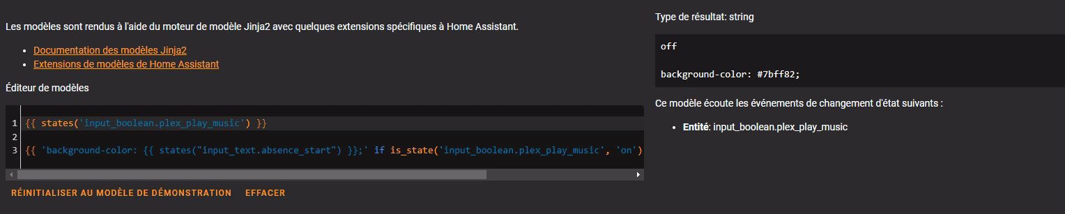

Ach ! J’ai encore un problème quand j’intègre cela dans mon code définitif :
{{ 'background-color: {{ states("input_text.coul_fond_porte") }}' if is_state('binary_sensor.capteur_porte_entree_secondaire_ouverture', 'on') else 'background-color: #7bff82' }};
Si je remplace
par
{{ 'background-color: red'
ça fonctionne, sinon le fond est blanc, et j’ai bien vérifié dans Outils de développement => MODÈLE que l’input contenait bien la valeur « red » ![]()
Avec ça :
card_mod:
style: |
ha-card {
color: yellow;
{% if is_state('binary_sensor.capteur_porte_entree_secondaire_ouverture', 'on') %}
background-color: {{ states('input_text.coul_fond_porte') }};
background-color: #7bff82;
Merci de nouveau, Herbs, ta proposition fonctionne parfaitement.
Mais je ne comprends pas ce qui clochait dans celle que j’ai postée précédemment.
Toujours tester dans les outils de dev, ça aide à voir ce qui cloche :

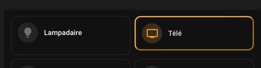

Je suis parvenu à jouer un peu avec card-moi, mais après avoir ajouter du code pour colorier le libellé d’une Mushroom card selon l’état de l’entité, ma carte n’a plus la même hauteur que les autres, et je ne comprends pas pourquoi.
card_mod:
style:
ha-card {
{% if is_state('light.lampadaire_outlet','on') %}
border: 2.5px outset orange;
border: 2.5px ousetgrey
{% endif %};
background: transparent;
height:40px;
mushroom-card:
mushroom-state-item:
mushroom-state-info:
div.container > span {
color: orange;
color: white;
{% endif %};
Depuis que j’ai ajouté la partie « mushroom-card », la hauteur de ma carte lampadaire a changé et est plus grande que les autres.
je cherche donc soit à réduire la hauteur de ma carte « Lampadaire » pour la remettre comme les autres, soit j’arrive à centrer en hauteur mon icône et le libellé, et dans ce cas je fais pareil sur les autres cartes.
L’un de vous aurait une idée s’il vous plait ?

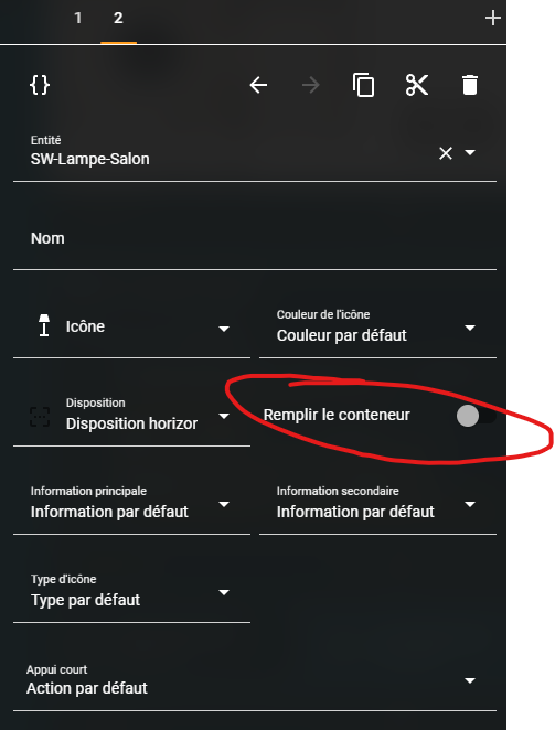

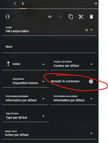

Via l’ui, dans les paramètres « mushroom » de la carte, essaie de cocher « remplir le conteneur » :
Et tu peux jouer avec l’option qui se trouve à gauche « Disposition », je dirai que toutes les cartes doivent être sur la même disposition.
bien vu, mais aucun changement
