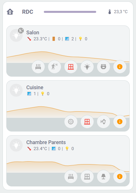

Tu es au top ! Merci beaucoup !

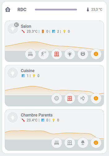

Tes cartes sont très sympa, j’aime bien la façon dont tu intégre le graphe !
Tu peux poster ton code c’est intéressant !

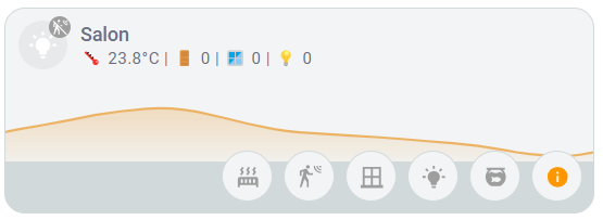

Bien sur !
Alors voici la carte seule :
  - type: custom:vertical-stack-in-card
    horizontal: false
        entity: light.lampe_sp
        card_mod:
          style:
            mushroom-shape-icon$: |
              .shape {
                {% if states(config.entity) == 'on' and state_attr(config.entity, 'brightness') != none %}
                  {% if state_attr(config.entity,'rgb_color') != none %}
                    background: linear-gradient(0deg, rgba{{(state_attr(config.entity,'rgb_color')[0] * 0.85, state_attr(config.entity,'rgb_color')[1] * 0.85, state_attr(config.entity,'rgb_color')[2] * 0.85) + (1,)}} calc( {{state_attr(config.entity,'brightness') | float / 2.55}}%), rgba{{(state_attr(config.entity,'rgb_color')[0] * 0.85, state_attr(config.entity,'rgb_color')[1] * 0.85, state_attr(config.entity,'rgb_color')[2] * 0.85) + (0.2,)}} 0.1%) !important;
                    background: linear-gradient(0deg, rgba(255, 152, 0)  | float / 2.55}}%, rgba(255, 152, 0) !important;
              .ha-state-icon {
                color: white; }
                --icon-color: white; !important;
        icon: mdi:lightbulb-on
        primary: Salon
        secondary: >
          🌡️ {{ states("sensor.interieur_temperature") | float | round(1) }}°C
          | 🚪 {{ states("sensor.compteur_portes_salon") }} | 🪟 {{
          states("sensor.compteur_fenetres_salon") }} | 💡 {{
          states("sensor.compteur_lumieres_salon") }} {% if
          is_state('light.lampe_sp', 'off') %} {% elif
          is_state('light.lampe_sp', 'off') %} {% else %}
            - {{ (states['light.lampe_sp'].attributes.brightness / 2.54) | round(0) }}%
        layout: horizontal
        tap_action:
          action: toggle
        badge_icon: |
          {% if is_state('binary_sensor.mouvements', 'on') %}
            mdi:motion-sensor
            mdi:motion-sensor-off
        badge_color: |
            orange
            grey
      - type: custom:mini-graph-card
          - entity: sensor.tvoc_temperature
        height: 50
        hours_to_show: 24
        points_per_hour: 1
        line_width: 2
        font_size: 20
        animate: true
        show:
          icon: false
          state: false
          legend: false
          fill: fade
      - type: custom:mushroom-chips-card
        chips:
          - type: template
            entity: switch.thermostat_salon_statut
            icon: mdi:radiator
            icon_color: |-
              {% if is_state(entity, 'on') %}
               orange
              {% elif is_state(entity, 'off') %}
               grey
               grey
            tap_action:
              action: more-info
          - type: template
            entity: binary_sensor.detecteur_de_mouvement_s_salon
            icon: mdi:motion-sensor
            icon_color: |-
               red
               grey
               grey
            tap_action:
              action: more-info
          - type: template
            entity: binary_sensor.fenetres_salon
            icon: mdi:window-closed-variant
            icon_color: |-
               red
               grey
               grey
            tap_action:
              action: more-info
          - type: template
            entity: light.lampe_tv
            icon_color: |-
               orange
               grey
               grey
            tap_action:
              action: toggle
            hold_action:
              action: more-info
          - type: template
            entity: switch.lampe_aquarium
            icon: mdi:fishbowl
            icon_color: |-
               orange
               grey
               grey
            tap_action:
              action: more-info
          - type: template
            entity: input_button.infos
            icon: mdi:information
            icon_color: orange
            tap_action:
              action: navigate
              navigation_path: /lovelace/salon
        alignment: end
        card_mod:
          style: |
            ha-card {
              padding-top: 0px;
              margin-top: -8px;
              padding-bottom: 8px;
              padding-left: 8px;
              padding-right: 8px;
    card_mod:
      style: |
        ha-card {
          margin: 10px;
          background: var(--mantle2);
Le reste c’est imbriqué dans un autre vertical-stack-in-card :slightly_smiling_face:

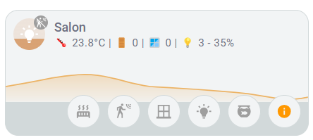

Petit détail, c’est l’adaptation du fond de l’icône en fonction du % d’éclairage de mes lampes :
C’est très sympa !
D’un point de vue personnel, je trouve très bien le petit chip « info » pour faire le lien vers la page dédiée:
Oui, j’ai longtemps hésité avec les pops ups mais je me suis dirigé vers différentes pages. Sur l’interface pc, c’est plus simple. Et en // j’ai une interface plus light sur mobile qui elle utilise les popups du bubble card :

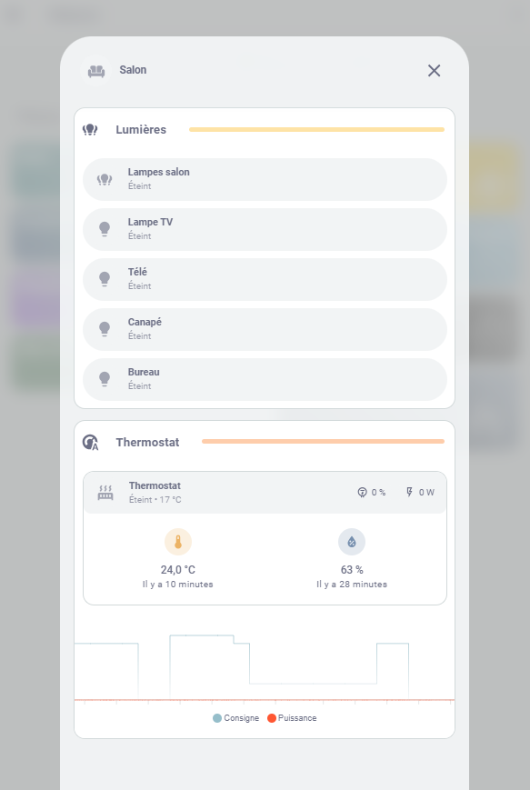

popup
type: vertical-stack
        entity: switch.groupe_chambre_1
        icon: |
          {% if is_state('switch.groupe_chambre_1', 'on') %}
            mdi:toggle-switch
          {% elif is_state('switch.groupe_chambre_1', 'off') %}

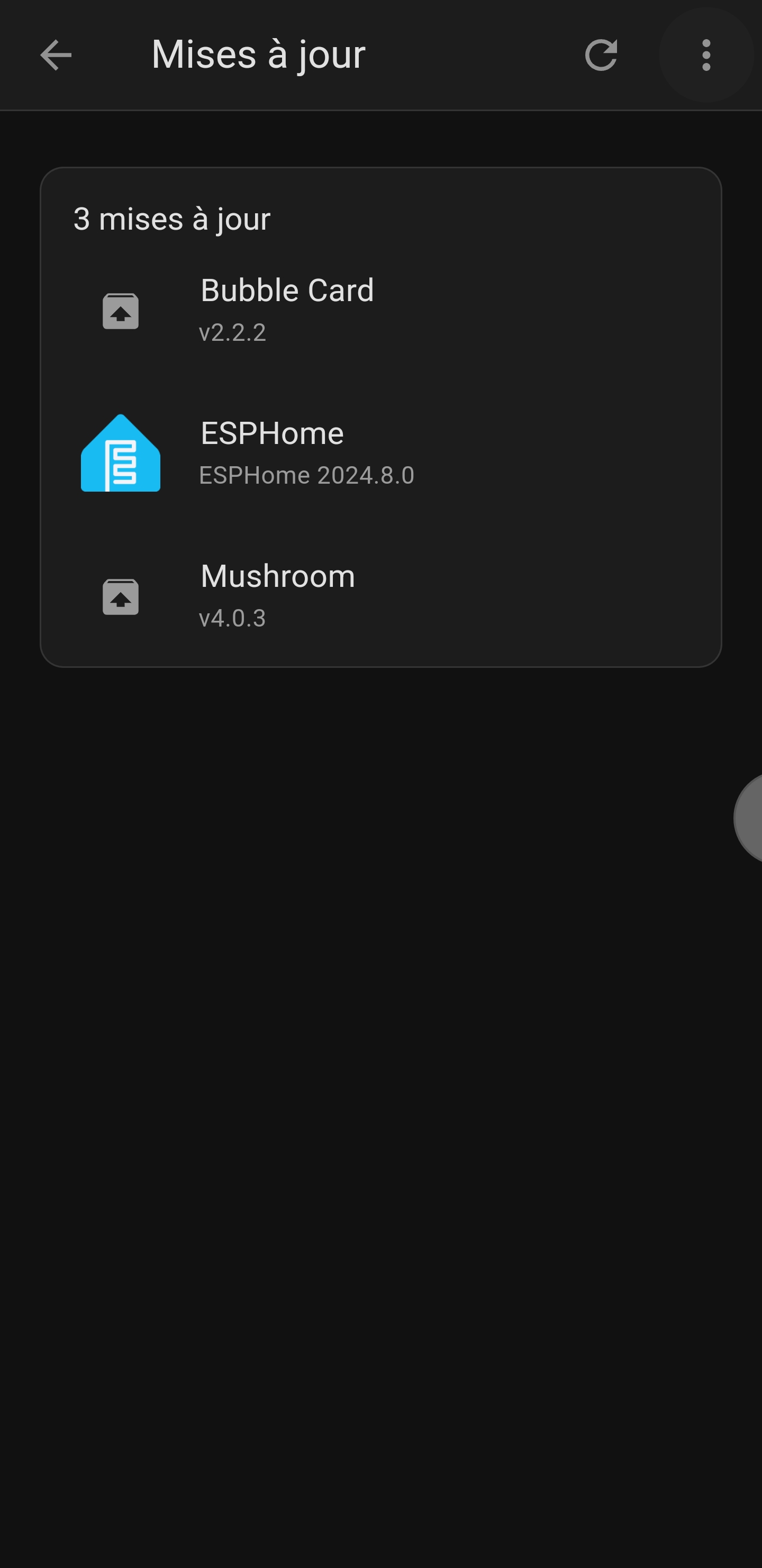

Merci, j’avais fini par trouver pour la carte Markdown. Après, je voulais en plus pouvoir les mettre à jour directement depuis la vue, j’avais donc modifié les paramètres HACS pour le faire avec des button-card même si la mise en forme était moins jolie. Malheureusement, j’ai supprimé ma page. Plus qu’à tout recommencer.
Je me contente de cliquer sur les liens pour voir le contenu des modifs (sur PC ou sur smartphone)
Mais je ne lance les mises à jour qu’au calme depuis le PC… Donc je n’ai pas tenté de faire comme toi un bouton pour lancer les updates.
Par contre ça marche comme ça pour les updates Home Assistant (OS et Core), mais en général j’évite de cliquer dessus, et j’attent d’être à la maison avec le PC pour le faire.
=> d’où la quantité d’update au retour de vacances (HACS et passage en 2024.8)
Par contre ce que tu décris doit être possible avec des cartes auto entities ou des templates de cartes declutering.

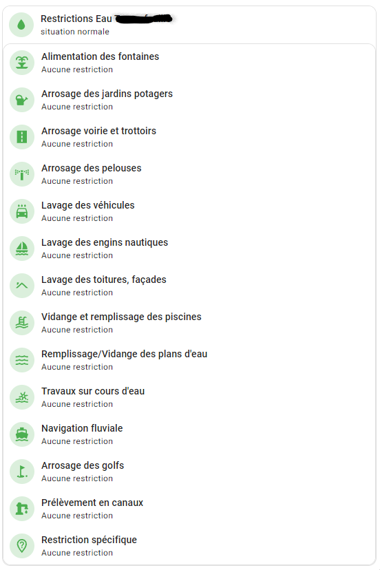

La carte de base trouvée sur le forum est plus comme ça:
mais j’ai eu un projet de passer en full mushroom (je ne suis pas allé jusqu’au bout mais j’ai gardé le brouillon…)

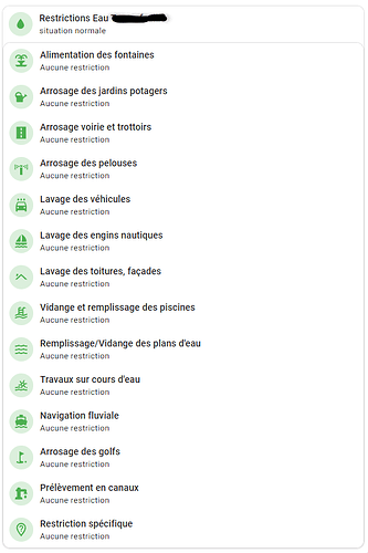

Un autre exemple sur les restrictions d’eau:
Une carte de synthèse puis du auto-entity (normalement filtré sur les item avec restrictions, mais là nous n’avons pas de restrictions…)
Pour HACS, tu peux très bien imaginer d’avoir une carte de synthèse (mushroom template ou markdown) comme celle que j’ai, puis des boutons auto-entity pour lancer les update…
Je pense comprendre ce que tu dis, mais pour pouvoir avoir les mises à jour, il faut modifier l’affichage des intégrations pour qu’elles s’affichent comme des entités, ce qui ne permet pas l’utilisation de Markdown. Ou du moins, je ne sais pas le faire :sweat_smile:
Ok.
Je n’avais pas compris cette subtilité…
Du coup tu as un capteur par integration…
En effet la carte markdown de synthèse ne marche pas, mais tu peux toujours faire du auto entity et n’afficher que les cartes ayant des updates actif…
Oui, du coup, elles sont affichées avec le reste.
C’était justement la méthode utilisée, mais l’inconvénient, c’est que si tu as 10 mises à jour, ça prend énormément de place.
Je vais essayer de refaire ce que j’avais, ça sera plus parlant en image.
