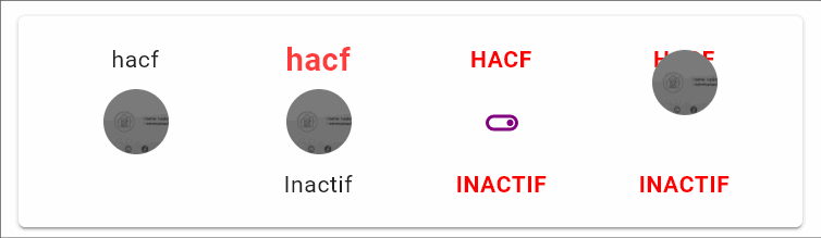

Voici quelques animations pour vous donnez des idées et surtout vous indiquez comment faire sur une carte Coup d'oeil (Glance) :
Il faut installer via HACS, le plugin/carte Card-mod.
Ensuite, amusez vous :
type: glance
  - entity: input_boolean.hacf
    image: /local/hacf.jpg
    style: |
      state-badge{
        {% if is_state('input_boolean.hacf', 'off') %}
          filter:  brightness(50%) grayscale(100%);
      div:nth-child(3){
          font-weight: 600;
          animation: pulsation 1.3s ease infinite;
          -webkit-animation: pulsation 1.3s ease infinite;
      @-webkit-keyframes pulsation {
        0% {
          background: transparent;
          color: white
        50% {
          transform: scale(1);
          color: white
        25%,75% {
          transform: scale(1.2);
          background: radial-gradient(circle, rgba(131,58,180,0.6485252808988764) 0%, rgba(253,29,29,0.8114466292134832) 0%, rgba(252,54,54,0.8) 30%, rgba(252,176,69,0) 50%);;
          color: white
        100% {
          color: white
      @keyframes pulsation {
        0% {
          color: white
        50% {
          color: white
        25%,75% {
          color: white
        100% {
          color: white
    style: |
      .name{
          color: red;
          font-weight: 600;
          animation: blink 2s infinite;
          -webkit-animation: blink 2s infinite
      state-badge{
      @-webkit-keyframes blink {
        0%,
        50%,
        100% {
          opacity: 1;
          font-size: 1.5em;
        25%,
        75% {
          opacity: 0;
          font-size: 1em;
      @keyframes blink {
        0%,
        50%,
        100% {
          opacity: 1;
          font-size: 1.5em;
        25%,
        75% {
          opacity: 0;
          font-size: 1em;
    style: |
      .name{
          font-weight: 600;
          color: red;
          text-transform: uppercase;
      state-badge{
          animation: jump 1.2s cubic-bezier(0,1.03,1,.01) 0s infinite normal;
          -webkit-animation: jump 1.2s cubic-bezier(0,1.03,1,.01) 0s infinite normal;
      div:nth-child(3){
          font-weight: 600;
          color: red;
      @-webkit-keyframes jump{
        0%,12%,100%{ transform:rotate(0); filter: brightness(1); }
        4%,8%{ transform:rotate(40deg) translateX(-0px);filter: brightness(10);}
        6%,10%{ transform:rotate(-40deg)translateX(0px);filter: brightness(10); }
      @keyframes jump{
    style: |
      .name{
          font-weight: 600;
          color: red;
      state-badge{
          animation: jump 1s ease-in-out 0s infinite normal;
          -webkit-animation: jump 1s ease-in-out 0s infinite normal;
      div:nth-child(3){
          font-weight: 600;
          color: red;
      @keyframes jump{
        0%,20%,50%,80%,100%{ transform:translateY(0); }
        40%{ transform:translateY(-30px); }
        60%{ transform:translateY(-15px); }
      @keyframes jump{

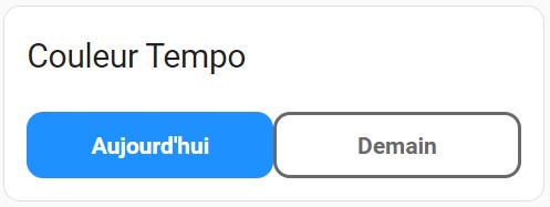

type: glance
title: Couleur Tempo
show_name: true
show_icon: false
show_state: false
  - entity: sensor.rte_tempo_couleur_actuelle
    card_mod:
      style: |
        :host .name {
          font-weight: bold;
          font-size: 120%;
          padding: 0.7em;
        :host {
          border-style: solid;
          border-radius: 12px;
          border-color: {% if is_state('sensor.rte_tempo_couleur_actuelle', 'ROUGE') %}
                          Red
                        {% elif is_state('sensor.rte_tempo_couleur_actuelle', 'BLANC') %}
                          DimGray
                        {% elif is_state('sensor.rte_tempo_couleur_actuelle', 'BLEU') %}
                          DodgerBlue
                          LightGray
                        {% endif %};
          background: {% if is_state('sensor.rte_tempo_couleur_actuelle', 'ROUGE') %}
                        red
                        White
                        DodgerBlue
                        LightGray
                      {% endif %};
           color: {% if is_state('sensor.rte_tempo_couleur_actuelle', 'BLANC') %}
                   DimGray
                   White
                  {% endif %};
  - entity: sensor.rte_tempo_prochaine_couleur
    card_mod:
      style: |
        :host .name {
          font-weight: bold;
          font-size: 120%;
          padding: 0.7em;
        :host {
          border-color: {% if is_state('sensor.rte_tempo_prochaine_couleur', 'ROUGE') %}
                          Red
                        {% elif is_state('sensor.rte_tempo_prochaine_couleur', 'BLANC') %}
                          DimGray
                        {% elif is_state('sensor.rte_tempo_prochaine_couleur', 'BLEU') %}
                          DodgerBlue
                          LightGray
                        {% endif %};
          background: {% if is_state('sensor.rte_tempo_prochaine_couleur', 'ROUGE') %}
                        red
                        White
                        DodgerBlue
                        LightGray
                      {% endif %};
           color: {% if is_state('sensor.rte_tempo_prochaine_couleur', 'BLANC') %}
                   DimGray
                   White
                  {% endif %};
