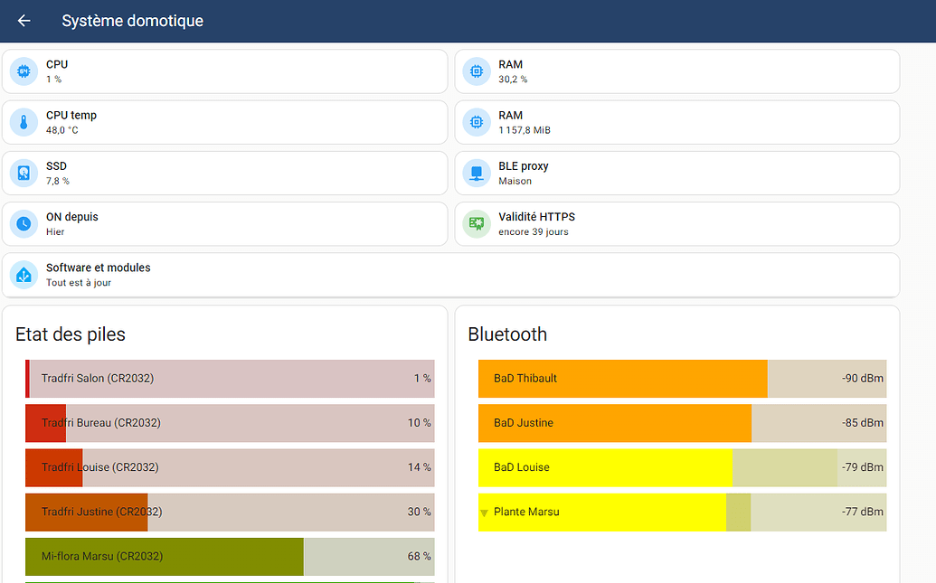

Carte automatique pour suivi des batteries
dans le même style que ma carte : ci-dessus

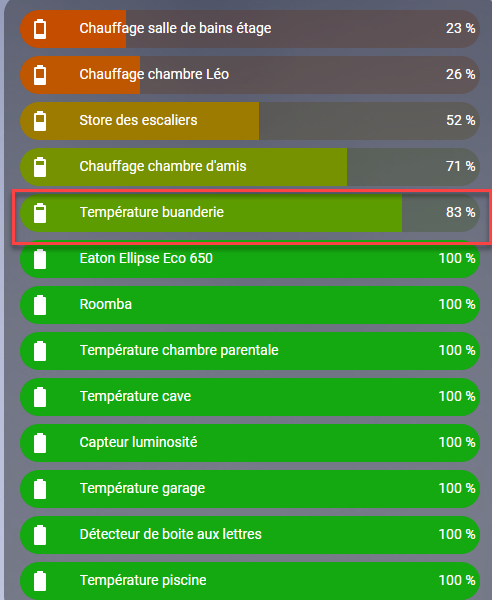

Juste avec une image c’est compliqué de retrouver par les multiples exemples du sujet comment ta carte serait construite.
Accessoirement custom:bar-card ne semble pas permettre de gérer l’action
Dac merci pour ta réponse.
Le code de ma carte :
type: custom:auto-entities
card:
  type: custom:bar-card
  title_position: inside
  height: 38
  positions:
    icon: inside
    indicator: inside
    value: inside
  show_icon: true
  align: split
  columns: '1'
  max: 100
  unit_of_measurement: '%'
  severity:
    - color: '#d11e1e'
      from: 0
      to: 5
      icon: mdi:battery-outline
    - color: '#cf2d11'
      from: 6
      to: 10
      icon: mdi:battery-10
    - color: '#cc3900'
      from: 11
      to: 15
    - color: '#c84400'
      from: 16
      to: 20
      icon: mdi:battery-20
    - color: '#c44d00'
      from: 21
      to: 25
    - color: '#bf5600'
      from: 26
      to: 30
      icon: mdi:battery-30
    - color: '#b95f00'
      from: 31
      to: 35
    - color: '#b36600'
      from: 36
      to: 40
      icon: mdi:battery-40
    - color: '#ac6e00'
      from: 41
      to: 45
    - color: '#a57500'
      from: 46
      to: 50
      icon: mdi:battery-50
    - color: '#9d7b00'
      from: 51
      to: 55
    - color: '#948100'
      from: 56
      to: 60
      icon: mdi:battery-60
    - color: '#8b8700'
      from: 61
      to: 65
    - color: '#818d00'
      from: 66
      to: 70
      icon: mdi:battery-70
    - color: '#769200'
      from: 71
      to: 75
    - color: '#6a9700'
      from: 76
      to: 80
      icon: mdi:battery-80
    - color: '#5d9c00'
      from: 81
      to: 85
    - color: '#4da100'
      from: 86
      to: 90
      icon: mdi:battery-90
    - color: '#39a500'
      from: 91
      to: 95
    - color: '#15a911'
      from: 96
      to: 100
      icon: mdi:battery
  style: |
    bar-card-currentbar, bar-card-current, bar-card-backgroundbar {
        height: 5px !important;
        margin-top: 30px;
    ha-card {
        background: none;
        box-shadow: none;
    ha-icon{
        color: white !important;
    bar-card-iconbar {
        margin-bottom: 10px;
  animation:
    state: 'on'
    speed: '2'
  card_mod: null
filter:
  include:
    - attributes:
        device_class: battery
      domain: sensor
      options: null
  exclude:
    - entity_id: sensor.*_battery_plus
    - entity_id: sensor.sm*
sort:
  exclude: []
  method: state
  numeric: true
show_empty: false

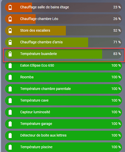

Je débute, et cette vue récapitulative des batteries me semble très intéressante et pertinente.
J’ai réussi à tout setup, j’ai installé les addons demandés, mais je crois comprendre que j’ai mal installé card-mod, car j’ai exactement le même résultat que présenté plus haut : la barre verte est épaisse, et fait toute la hauteur.

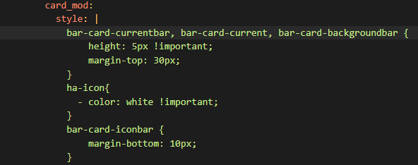

Même quand je colle un code à 100% sans le modifier, tout est OK sauf cette épaisseur de bande…
Je n’y connais rien en code, j’arrive à piger comment faire deux-trois modifications à partir d’un code fait, mais là, globalement j’ai la sensation qu’il ne prend pas en compte tout ce qui est dans « style » :
Tout ce texte vert, que je le supprime ou modifie les marges/hauteurs, rien ne change…
il dois te manquer card_mod a installer de HACS.
Il faut ajouter card_mod (et tout décaler
Au top, merci!
En fait à un autre endroit du code, il y avait card_mod: null
Je pense que ça faisait du coup ignorer le reste.
J’ai pu corriger ça en supprimant le null.
Merci!

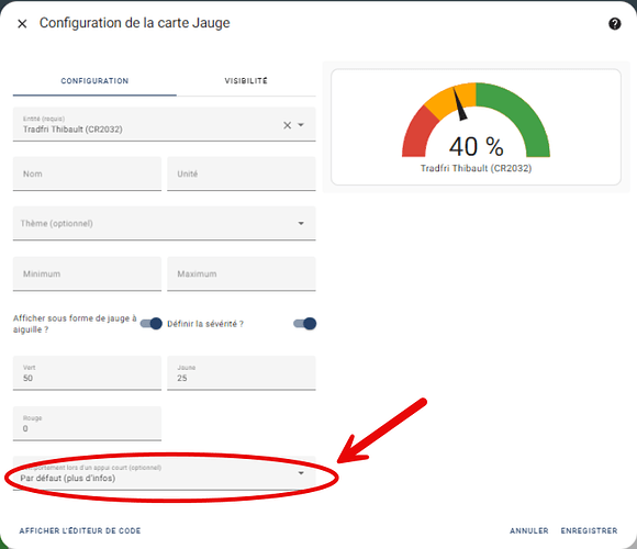

Alors si c’est pour tester il te faut essayer avec une carte qui permette de definir une action au clic.
J’avais gardé un test avec des jauges, je l’ai modifié pour mettre un lien vers ce post du forum pour mettre un truc sur le clic :rofl:
voici le code avec une carte jauge (gauge)
attention, chez moi le filtre est sur le friendly name et sur le type de pile, pas sur le device class ou le nom de l’entité comme dans ton code.
Pense à remettre tes filtres…

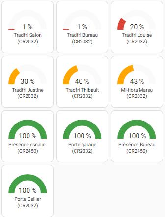

Le rendu visuel (mais comme c’est pour du test, si c’est moche, ce n’est pas très grave):

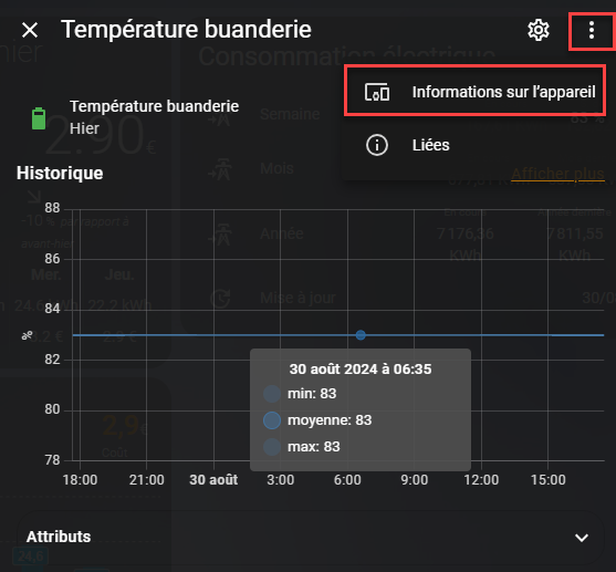

Ensuite vient le problème de pouvoir trouver le chemin dynamique, c’est à dire qui fonctionne pour chaque entité.
PS : quand je teste ce chemin sur un bouton, cela fonctionne pour aller sur la page du sensor :
tap_action:
  action: navigate
  navigation_path: /config/devices/device/69120792dbb296e7a3782249ad4946bc
Une idée ?
