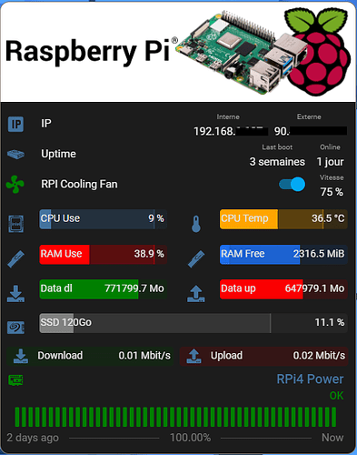

Bonjour a tous,
Vue le nombre de demande des cartes de mon dashboard, je vous les centralisent dans ce post pour que toute le monde en profite.
Carte Raspberry pi :
Code
type: custom:stack-in-card
mode: vertical
keep:
  box_shadow: true
  margin: true
  border_radius: true
  background: true
  outer_padding: false
  - type: vertical-stack
      - type: picture
        image: /local/images/RPi4B3.png
        card_mod:
          style: |
            ha-card {
              border-radius: 0px;
      - type: entities
          - entity: sensor.local_ip
            type: custom:multiple-entity-row
            show_state: false
              - entity: binary_sensor.wan_status_2
                attribute: wan_ipaddress
        card_mod:
          style: |
            .card-content div {
              margin-top: -15px !important;
              margin-left: -15px !important;
              margin-bottom: 0px  !important;
            :host {
              font-size: 15px;
            ha-card {
              --mdc-icon-size: 28px;
      - type: entities
          - entity: sensor.last_boot
            show_state: false
                format: total
              - entity: sensor.temps_online
                format: total
            icon: phu:raspberry-pi
        card_mod:
          style: |
            .card-content div {
              margin-top: -40px !important;
              margin-bottom: 25px  !important;
            :host {
              font-size: 15px;
            ha-card {
      - type: entities
          - entity: light.rpi_cooling_fan
            show_state: false
            state_color: false
                toggle: true
                attribute: brightness
                hide_unavailable: true
                format: brightness
            icon: mdi:fan
            card_mod:
              style:
                hui-generic-entity-row $: |
                  state-badge {
                    {% if is_state('light.rpi_cooling_fan','on') %}
                      animation: rotation_1 2s linear infinite;
                      color: green
                       animation: none;
                      color: red
                  @keyframes rotation_1 {
                    0% {
                      transform: rotate(0deg);
                    100% {
                      transform: rotate(359deg);
        card_mod:
          style: |
            .card-content div {
              margin-top: -65px !important;
            :host {
              font-size: 15px;
            ha-card {
              --mdc-icon-size: 30px;
      - type: horizontal-stack
          - type: custom:bar-card
              - entity: sensor.processor_use
                icon: phu:intel-cpu
                color: rgb(68, 115, 158)
                height: 27px
                min: '0'
                max: '100'
                target: '90'
                positions:
                  indicator: 'off'
            card_mod:
              style: |
                ha-card {
                  top: -31px;
                  margin-top: -20px;
                  margin-left: -15px;
                  margin-right: -5px;
                bar-card-currentbar, bar-card-backgroundbar {
                  border-radius: 4px;
                ha-icon {
                bar-card-name {
                  margin: 2px;
              - entity: sensor.processor_temperature
                icon: mdi:thermometer
                height: 27px
                color: orange
                min: '1'
                max: '80'
                target: '65'
                positions:
                  indicator: 'off'
            card_mod:
              style: |
                ha-card {
                  top: -31px;
                  margin-top: -20px;
                  margin-left: -15px;
                  margin-right: -5px;
                  background: none;
                  border-radius: 4px;
                ha-icon {
                bar-card-name {
                  margin: 2px;
              - entity: sensor.memory_use_percent
                icon: phu:ram-memory
                height: 27px
                color: red
                min: '0'
                max: '100'
                target: '90'
                positions:
                  indicator: 'off'
            card_mod:
              style: |
                ha-card {
                  margin-top: -62px;
                  margin-left: -15px;
                  margin-right: -5px;
                ha-icon {
                  border-radius: 4px;
                bar-card-name {
                  margin: 2px;
              - entity: sensor.memory_free
                color: rgb(31, 111, 235)
                height: 27px
                min: '1'
                max: '3700'
                target: '300'
                positions:
                  indicator: 'off'
            card_mod:
              style: |
                ha-card {
                  margin-top: -62px;
                  margin-left: -15px;
                  margin-right: -5px;
                ha-icon {
                  border-radius: 4px;
                bar-card-name {
                  margin: 2px;
              - entity: sensor.network_in_eth0
                icon: fas:download
                height: 27px
                color: green
                min: '1'
                max: '1000000'
                positions:
                  indicator: 'off'
                decimal: '1'
                unit_of_measurement: Mo
            card_mod:
              style: |
                ha-card {
                  margin-top: -32px;
                  margin-left: -15px;
                  margin-right: -5px;
                ha-icon {
                  --mdc-icon-size: 24px;
                  border-radius: 4px;
                bar-card-name {
                  margin: 2px;
              - entity: sensor.network_out_eth0
                icon: fas:upload
                color: rgb(250, 0, 1)
                height: 27px
                min: '1'
                max: '1000000'
                positions:
                  indicator: 'off'
                decimal: '1'
            card_mod:
              style: |
                ha-card {
                  margin-top: -32px;
                  margin-left: -15px;
                  margin-right: -5px;
                ha-icon {
                  border-radius: 4px;
                bar-card-name {
                  margin: 2px;
              - entity: sensor.disk_use_percent
                icon: phu:seagate-ssd
                height: 27px
                color: grey
                min: '0'
                max: '100'
                target: '75'
                positions:
                  indicator: 'off'
            card_mod:
              style: |
                ha-card {
                  margin-top: -33px;
                  margin-left: -15px;
                  margin-right: -5px;
                  border-radius: 4px;
                ha-icon {
                bar-card-name {
                  margin: 2px;
          - entity: sensor.network_throughput_in_eth0
            height: 27px
            color: green
            icon: fas:download
        decimal: '2'
        unit_of_measurement: Mbit/s
        positions:
          icon: inside
          indicator: 'off'
          minmax: 'off'
          value: inside
        entity_row: true
        card_mod:
          style: |
            ha-card {
              font-size: 14px;
              --bar-card-border-radius: 5px;
              margin-top: -18px;
              margin-left: 8px;
              margin-right: 2px;
              --mdc-icon-size: 20px;
          - entity: sensor.network_throughput_out_eth0
            icon: fas:upload
            height: 27px
        decimal: '2'
        positions:
          icon: inside
          indicator: 'off'
          minmax: 'off'
          value: inside
        entity_row: true
        card_mod:
          style: |
            ha-card {
              font-size: 14px;
              margin-top: -18px;
              margin-left: -2px;
              margin-right: 10px;
  - type: custom:uptime-card
    entity: binary_sensor.rpi_power_status
    title_template: RPi4 Power
    ok: 'off'
    ko: 'on'
    bar:
      amount: 48
      round: 1
      height: 29
    hours_to_show: 48
    init:
      animation: raise
    color:
      title: rgb(68, 115, 158)
      ko: rgb(250, 0, 1)
      ok: green
    title_adaptive_color: false
    icon_adaptive_color: true
    tooltip_adaptive_color: true
    status_adaptive_color: true
    show:
      header: true
      title: true
      timeline: true
      footer: true
      average: true
    tooltip:
      hour24: true
      animation: true
    alias:
      ok: OK
      ko: Danger
    tap_action:
      action: more-info
    alignment:
      icon_first: true
      status: left
      tooltip_first: true
      header: spaced
    card_mod:
      style: |
        :host {
          font-size: 15px;
        ha-card {
          top: -17px;
          margin-left: -7px;
          margin-bottom: -25px;
          background: none;
  - type: custom:popup-card
    style: |-
      --popup-border-radius: 10px;
      --popup-background-color: transparent;
      --popup-border-width: 0px;
      --popup-min-width: 500px;
      --popup-max-width: 600px;
    card:
      type: custom:mini-graph-card
      icon: phu:intel-cpu
      height: 101
      hours_to_show: 24
      points_per_hour: 2
      hour24: true
      line_width: 3
      show:
        fill: true
        graph: line
        icon: true
        state: true
        labels: false
        extrema: true
        average: true
      align_icon: right
      align_state: center
      line_color: rgb(68, 115, 158)
      font_size: 100
      animate: false
      card_mod:
        style: |
          ha-card .header.flex .icon {
            color: rgb(31, 111, 235);
            --mdc-icon-size: 40px;
          .fill {
            fill: white;
            opacity: 1 !important;
    style: |-
    card:
      name: CPU Température
      height: 101
      hours_to_show: 24
      points_per_hour: 2
      hour24: true
      line_width: 6
      show:
        fill: true
        graph: line
        icon: true
        state: true
        labels: false
        extrema: true
        average: true
      align_icon: right
      align_state: center
      font_size: 100
      animate: false
      card_mod:
        style: |
            --mdc-icon-size: 37px;
          .fill {
            fill: white;
    style: |-
    card:
      height: 100
      hours_to_show: 24
      points_per_hour: 2
      hour24: true
      line_width: 6
      show:
        fill: false
        graph: line
        icon: true
        state: true
        labels: false
        extrema: true
        average: true
        labels_secondary: true
        - color: rgb(31, 111, 235)
          show_line: true
          show_points: true
          show_label: true
          show_legend: true
          y_axis: secondary
      align_icon: right
      align_state: left
      line_color: rgb(250, 0, 1)
      font_size: 90

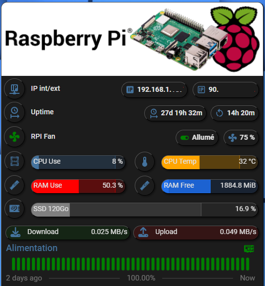

Image bandeau :
Pour le monotoring du RPI [ CARTE ] Cartes diverses ( Livebox, NAS, RPI, BLE Proxy...) - #32 par WarC0zes

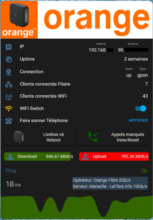

Carte Livebox :
Code
mode: vertical
keep:
  box_shadow: true
  margin: true
  border_radius: true
  background: true
  - type: entities
    header:
      type: picture
      image: /local/images/Orange3.png
        icon: mdi:ip
        show_state: false
          - entity: device_tracker.sagemcom_broadband_sas_2b_18_c0
            attribute: ip
          - attribute: wan_ipaddress
        icon: mdi:web-clock
        show_state: false
          - attribute: uptime
            format: total
        icon: mdi:wan
        show_state: false
          - attribute: link_state
          - attribute: link_type
        name: Clients connectés Filaire
        icon: fas:network-wired
        show_state: false
          - attribute: wired clients
        name: Clients connectés WiFi
        icon: mdi:access-point-network
        show_state: false
          - attribute: wireless clients
      - entity: switch.wifi_switch_2
        icon: fas:wifi
        toggle: true
        state_color: true
        show_state: true
      - entity: button.ring_your_phone_2
        name: Faire sonner Téléphone
    state_color: true
    show_header_toggle: false
    card_mod:
      style: |
        .card-content div {
          margin-top: -3px !important;
          margin-left: -10px !important;
          margin-bottom: 2.3px  !important;
        :host {
          font-size: 15px;
        ha-card {
          box-shadow: none;
  - type: custom:mod-card
    style:
        ha-card {
          margin: -8px 10px 0 10px;
    card:
        - type: custom:button-card
          entity: button.livebox_restart_2
          color_type: icon
          name: Livebox v6<br/>Reboot
          show_entity_picture: true
          entity_picture: /local/images/Livebox.png
          color: '#44739e'
          aspect_ratio: 4.55/1
          layout: icon_name
          styles:
            card:
              - padding: 0.2em
              - margin: '-10px 0'
              - '--mdc-ripple-color': '#44739e'
              - '--mdc-ripple-press-opacity': 0.5
            icon:
              - opacity: 1
            name:
              - font-size: 0.85em
              - white-space: normal
            state:
              - font-size: 0.75em
            label:
              - font-size: 0.65em
          hold_action:
            action: more-info
          card_mod:
            style: |
              ha-card {
                box-shadow: 0px 2px 4px 0px rgba(0,0,0,0.7);
          entity: binary_sensor.call_missed_2
          color_type: icon
          icon: mdi:phone-alert
          name: Appels manqués View/Reset
          layout: icon_name
          state:
            - value: 'on'
            - value: 'off'
              color: rgb(0, 102, 0)
              icon: mdi:phone-check
          styles:
            card:
              - padding: 0.2em
              - margin: '-10px 0'
            icon:
              - opacity: 1
            name:
              - font-size: 0.85em
            state:
              - font-size: 0.75em
            label:
              - font-size: 0.65em
          double_tap_action:
            action: call-service
            service: livebox.remove_call_missed
          hold_action:
            action: more-info
          card_mod:
            style: |
              ha-card {
          - entity: sensor.speedtest_cli_download
            icon: fas:download
            color: '#336600'
            entity_row: true
            min: 1
            max: 1000
            positions:
              icon: inside
              minmax: 'off'
            animation:
              state: 'on'
              speed: '1'
            height: 27px
        card_mod:
          style: |
            ha-card {
              font-size: 14px;
              box-shadow: none;
              margin: -10px -12px 0px -5px;
          - entity: sensor.speedtest_cli_upload
            direction: right
            icon: fas:upload
            entity_row: true
            min: 1
            max: 800
            positions:
              icon: inside
              minmax: 'off'
            animation:
              state: 'on'
              speed: '1'
            height: 27px
            decimal: '2'
        card_mod:
          style: |
            ha-card {
              font-size: 14px;
              box-shadow: none;
              margin: -10px -5px 0px -12px;
  - type: custom:mini-graph-card
    decimals: 0
    hour24: true
    height: 80
    hours_to_show: 24
    points_per_hour: 1
    line_width: 2
      - entity: sensor.speedtest_cli_ping
    show:
      fill: true
      graph: line
      icon: true
      state: true
      labels: false
      extrema: false
      average: false
    align_icon: right
    align_state: left
    font_size: 70
    animate: false
    color_thresholds:
      - value: 22
        color: '#336600'
      - value: 24
        color: '#f39c12'
      - value: 25
        color: '#d35400'
      - value: 26
        color: '#c0392b'
    card_mod:
      style: |
        ha-card .header.flex .name.flex {
          color: #44739e;
          font-size: 14px;
          color: #44739e;
        .fill {
          fill: white;
        ha-card {
          margin-top: -18px !important;
          box-shadow: none;
        ha-card .states.flex::after {
          content: "Opérateur: {{states('sensor.speedtest_isp')}} Fibre 2Gb/s \A Serveur: {{states('sensor.speedtest_location')}} - {{states('sensor.speedtest_server_name')}} 10Gb/s";
          white-space: pre;
          background-color: rgba(68, 115, 158,0.4);
          padding: 2px 2px 0px 2px;
          margin-top: -10px;
          border-radius: 5px;
          font-size: 14px;
card_mod:
  style: |
    ha-card {
      box-shadow: 0 0 0 1px gray;
Image bandeau :
Icone :
Pour speedtest, voir ce tuto Speedtest

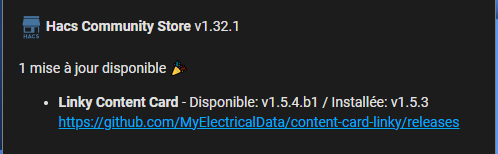

Carte HACS :
Code
  - type: markdown
    content: >-
      <span><ha-icon icon="hacs:hacs"></ha-icon> <b>Hacs Community Store</b>
      v{{states('sensor.hacs_version') }}</span>
      </br>{% if is_state('sensor.hacs', '0') or
      is_state('sensor.hacs','unknown') %} Aucune mise à jour {% else %}
      {{states('sensor.hacs') }} {{ 'mise à jour disponible' if
      is_state('sensor.hacs', '1') else 'mises à jour disponibles' }}
      {{'\U0001f389'}}
      {% for repo in state_attr('sensor.hacs', 'repositories') %} -
      <b>{{repo.display_name }}</b> - Disponible: {{ repo.available_version }} /
      Installée: {{repo.installed_version }} https://github.com/{{ repo.name
      }}/releases
      {% endfor %} {% endif %}
    card_mod:
      style: |
        :host {
          --card-mod-icon-color: rgb(68, 115, 158);
Pour le sensor.hacs_version c’est un command_line, a mettre dans command_line.yaml :
- sensor:
    scan_interval: 86400
    command: >
      grep -oP '"version": "\K[^"]+' custom_components/hacs/manifest.json

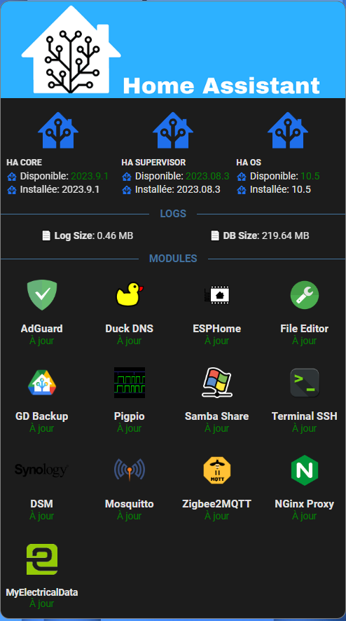

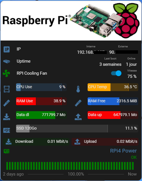

      --text-divider-font-size: 15px;
  - type: picture
    image: /local/images/home-assistant2.png
    card_mod:
      style: |
        ha-card {
          border-radius: 0px;
        entity: update.home_assistant_core_update
        icon: mdi:home-assistant
        aspect_ratio: 1.1/1
        styles:
          card:
            - color: var(--text-medium-color)
            - padding-left: 10px
            - border-radius: 20px
            - padding: 5%
            - font-size: 14px
            - text-transform: capitalize
            - border-radius: 0px
            - size: 50px
          grid:
            - grid-template-areas: '"i i" "n n" "cpu cpu" "ram ram" "sd sd"'
            - grid-template-columns: 1fr 1fr
            - grid-template-rows: 1fr min-content min-content min-content min-content
          name:
            - font-weight: bold
            - font-size: 12px
            - align-self: middle
            - justify-self: start
            - padding-bottom: 4px
            - color: var(--text-color)
          icon:
            - color: |
                  if (entity.state == 'on') return 'red';
                  return 'rgb(31, 111, 235)';
            - width: 45%
            - animation: >
                [[[ if (entity.state == 'on') return 'blink 2s ease infinite';
          custom_fields:
            cpu:
              - '--text-color-sensor': >-
                  [[[if
                  (states['update.home_assistant_core_update'].attributes.latest_version
                  states['update.home_assistant_core_update'].attributes.installed_version)
                  return "red";else return "green"]]]
              - padding-bottom: 2px
            ram:
        custom_fields:
          cpu: |
              return `<ha-icon icon="mdi:home-assistant" style="width: 16px; height: 16px; color: rgb(31, 111, 235);"></ha-icon>
              <span>Disponible: <span style="color: var(--text-color-sensor);">${states['update.home_assistant_core_update'].attributes.latest_version}</span></span>`
          ram: |
              return `<ha-icon icon='mdi:home-assistant' style='width: 16px; height: 16px; color: rgb(31, 111, 235);'></ha-icon>
              <span>Installée: <span style='color: var(--text-color-sensor);'>${states['update.home_assistant_core_update'].attributes.installed_version}</span></span>`
        entity: update.home_assistant_supervisor_update
        name: HA SUPERVISOR
        aspect_ratio: 1.1/1
        styles:
          card:
            - padding: 5%
            - font-size: 14px
            - size: 50px
          grid:
          name:
            - font-weight: bold
            - font-size: 12px
          icon:
            - color: |
            - width: 45%
            - animation: >
          custom_fields:
            cpu:
                  [[[if
                  (states['update.home_assistant_supervisor_update'].attributes.latest_version
                  states['update.home_assistant_supervisor_update'].attributes.installed_version)
            ram:
        custom_fields:
          cpu: |
              <span>Disponible: <span style="color: var(--text-color-sensor);">${states['update.home_assistant_supervisor_update'].attributes.latest_version}</span></span>`
          ram: |
              <span>Installée: <span style='color: var(--text-color-sensor);'>${states['update.home_assistant_supervisor_update'].attributes.installed_version}</span></span>`
        entity: update.home_assistant_operating_system_update
        aspect_ratio: 1.1/1
        styles:
          card:
            - padding: 5%
            - font-size: 14px
            - size: 50px
          grid:
          name:
            - font-weight: bold
            - font-size: 12px
          icon:
            - color: |
            - width: 45%
            - animation: >
          custom_fields:
            cpu:
                  [[[if
                  (states['update.home_assistant_operating_system_update'].attributes.latest_version
                  states['update.home_assistant_operating_system_update'].attributes.installed_version)
            ram:
        custom_fields:
          cpu: |
              <span>Disponible: <span style="color: var(--text-color-sensor);">${states['update.home_assistant_operating_system_update'].attributes.latest_version}</span></span>`
          ram: |
              <span>Installée: <span style='color: var(--text-color-sensor);'>${states['update.home_assistant_operating_system_update'].attributes.installed_version}</span></span>`
  - type: custom:text-divider-row
    text: LOGS
      - type: markdown
        content: >-
          <center>📄 <strong>Log Size</strong>: {{
          states("sensor.home_assistant_log_size") }} MB</center>
        card_mod:
          style: |
            :host {
            ha-card {
              top: -15px;
      - type: markdown
        content: >-
          <center>📄 <strong>DB Size</strong>: {{
          (states('sensor.home_assistant_v2_db_size') | float(0) / 1.049) |
          round(2) }} MB</center>
        card_mod:
          style: |
            :host {
            ha-card {
              top: -15px;
    text: MODULES
    align: center
  - type: grid
    square: true
    columns: 4
        entity: update.adguard_home_update
        aspect_ratio: 1/1
        show_icon: false
        entity_picture: /local/images/adguard.png
        show_label: true
        label: |
            if (states['update.adguard_home_update'].state == "on") return '<font color="red">Mise à jour</font>';
            else return '<font color="green">À jour</font>';
        state:
          - value: 'on'
            styles:
              state:
                - color: red
          - value: 'off'
            styles:
              state:
                - color: green
        styles:
          card:
            - padding: 0.2em
            - '--mdc-ripple-color': rgb(68, 115, 158)
            - transition: true
            - font-size: 18px
          icon:
            - opacity: 1
            - animation: >
          name:
            - font-weight: bold
            - font-size: 0.85em
          state:
            - font-size: 0.75em
          label:
            - font-size: 0.75em
        card_mod:
          style: |
            ha-card {
              top: -10px !important;
        entity: update.duck_dns_update
        aspect_ratio: 1/1
        show_icon: false
        entity_picture: /local/images/duckdns.png
        show_label: true
        label: |
            if (states['update.duck_dns_update'].state == "on") return '<font color="red">Mise à jour</font>';
        state:
          - value: 'on'
            styles:
              state:
                - color: red
          - value: 'off'
            styles:
              state:
                - color: green
        styles:
          card:
            - padding: 0.2em
            - transition: true
            - font-size: 18px
          icon:
            - opacity: 1
            - animation: >
          name:
            - font-weight: bold
            - font-size: 0.85em
          state:
            - font-size: 0.75em
          label:
            - font-size: 0.75em
        card_mod:
          style: |
            ha-card {
        entity: update.esphome_update
        aspect_ratio: 1/1
        show_icon: false
        entity_picture: /local/images/esphome.png
        show_label: true
        label: |
            if (states['update.esphome_update'].state == "on") return '<font color="red">Mise à jour</font>';
        state:
          - value: 'on'
            styles:
              state:
                - color: red
          - value: 'off'
            styles:
              state:
                - color: green
        styles:
          card:
            - padding: 0.2em
            - transition: true
            - font-size: 18px
          icon:
            - opacity: 1
            - animation: >
          name:
            - font-weight: bold
            - font-size: 0.85em
          state:
            - font-size: 0.75em
          label:
            - font-size: 0.75em
        card_mod:
          style: |
            ha-card {
        entity: update.file_editor_update
        aspect_ratio: 1/1
        show_icon: false
        entity_picture: /local/images/fileeditor.png
        show_label: true
        label: |
            if (states['update.file_editor_update'].state == "on") return '<font color="red">Mise à jour</font>';
        state:
          - value: 'on'
            styles:
              state:
                - color: red
          - value: 'off'
            styles:
              state:
                - color: green
        styles:
          card:
            - padding: 0.2em
            - transition: true
            - font-size: 18px
          icon:
            - opacity: 1
            - animation: >
          name:
            - font-weight: bold
            - font-size: 0.85em
          state:
            - font-size: 0.75em
          label:
            - font-size: 0.75em
        card_mod:
          style: |
            ha-card {
        entity: update.home_assistant_google_drive_backup_update
        aspect_ratio: 1/1
        show_icon: false
        entity_picture: /local/images/google drive.png
        show_label: true
        label: |
            if (states['update.home_assistant_google_drive_backup_update'].state == "on") return '<font color="red">Mise à jour</font>';
        state:
          - value: 'on'
            styles:
              state:
                - color: red
          - value: 'off'
            styles:
              state:
                - color: green
        styles:
          card:
            - padding: 0.2em
            - transition: true
            - font-size: 18px
          icon:
            - opacity: 1
            - animation: >
          name:
            - font-weight: bold
            - font-size: 0.85em
          state:
            - font-size: 0.75em
          label:
            - font-size: 0.75em
        card_mod:
          style: |
            ha-card {
        entity: update.pigpio_update
        aspect_ratio: 1/1
        show_icon: false
        entity_picture: /local/images/pigpio.png
        show_label: true
        label: |
        state:
          - value: 'on'
            styles:
              state:
                - color: red
          - value: 'off'
            styles:
              state:
                - color: green
        styles:
          card:
            - padding: 0.2em
            - transition: true
            - font-size: 18px
          icon:
            - opacity: 1
            - animation: >
          name:
            - font-weight: bold
            - font-size: 0.85em
          state:
            - font-size: 0.75em
          label:
            - font-size: 0.75em
        card_mod:
          style: |
            ha-card {
        entity: update.samba_share_update
        aspect_ratio: 1/1
        show_icon: false
        entity_picture: /local/images/samba.png
        show_label: true
        label: |
            if (states['update.samba_share_update'].state == "on") return '<font color="red">Mise à jour</font>';
        state:
          - value: 'on'
            styles:
              state:
                - color: red
          - value: 'off'

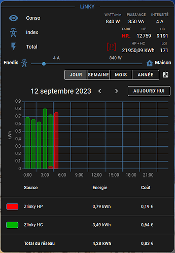

Pour cumuler les HP+HC, dans le template.yaml:
- sensor:
    - name: zlinky_metering_HC_HP_sum
      unit_of_measurement: "Wh"
      device_class: energy
      state_class: total_increasing
      state: >-
          {% set HC = states('sensor.0x00158d0005d299cf_hchc')|float(default=0)*1000 %}
          {% set HP = states('sensor.0x00158d0005d299cf_hchp')|float(default=0)*1000 %}
          {{ HC + HP | int(default=0) }}
      availability: "{{ states('sensor.0x00158d0005d299cf_hchc')|is_number and states('sensor.0x00158d0005d299cf_hchp')|is_number }}"
Image bandeau WLED:
Pour les couleurs du panneau energy, faut créer un thème et inclure ce code pour modifier les couleurs + supprime les bordures:
theme_noborder:
  ha-card-border-width: 0
  energy-grid-consumption-color-0: '#FF0000'
  energy-grid-consumption-color-1: '#00b300'
  card-mod-theme: theme_noborder
  card-mod-card: |
    ha-card > div > div > table > tbody > tr:nth-child(1) >
    td.mdc-data-table__cell.cell-bullet > div {
      background: #FF0000 !important;
    ha-card > div > div > table > tbody > tr:nth-child(2) >
      background: #00b300 !important;
  modes:
    light: {}
    dark: {}

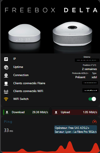

J’ai aussi un problème d’affiche sur mon min graph, je ne vois que la courbe d’upload en rouge. La courbe de download verte ne se voit que dans les angles inférieur de ma fenêtre.
La carte mini graph est utiliser pour afficher le ping. Le download et upload sont sur les deux bar.

@WarC0zes
Je commence à être pas mal sur ma carte
mon seul problème maintenant c’est le chevauchement de mes cartes comme tu peux le voir dans mes gribouillis rouge. J’ai cherché avec l’outils developpement de chrome les valeurs à changer mais choux blanc.
Par la meme occasion peux t’on changer l’echelle du graphe et des boutons Download et Upload car comme tu peux le constater ils manquent de consistence dans leur affichage.
Cordialement.
pour ce problème, dans la carte mod-card modifie le margin de -5px passe a 0,5,10px … a toi de voir.
        style:
            ha-card {
              margin: -5px 10px 0px 10px;
        card:
Pour les bars de download et upload, c’est dans la partie card_mod et joue avec margin ou supprime la ligne complète pour avoir la marge par défaut ( c’est ligne margin: -10px -12px 0px -5px;).
        card_mod:
          style: |
            ha-card {
              font-size: 14px;
              box-shadow: none;
et pour la hauteur des bars c’est l’option height: 27px a augmenter.
Pour le mini-graph, faut augmenter height: 80. Mets 100,120 …
@WarC0zes
Merci à toi

@jerome6994
Le code
mode: vertical
keep:
  box_shadow: true
  margin: true
  border_radius: true
  background: true
  - type: entities
    header:
      type: picture
      image: /local/freebox_delta_1.jpg
      - entity: binary_sensor.freebox_server_wan_status
        icon: mdi:ip
        show_state: false
          - entity: device_tracker.freebox_v7_r1
            attribute: IPv4
            attribute: mac
        icon: mdi:web-clock
        show_state: false
            attribute: uptime
            format: total
        icon: mdi:wan
        show_state: false
            content: ' {ADSL2+} '
            attribute: connection_type
        icon: mdi:network
        show_state: false
        show_state: false
      - entity: switch.freebox_wifi
        icon: mdi:wifi
        toggle: true
        state_color: true
        show_state: true
      - entity: button.reboot_freebox
    state_color: true
    card_mod:
      style: |
        .card-content div {
        :host {
          font-size: 15px;
        ha-card {
          box-shadow: none;
    style:
        ha-card {
          margin: 5px 10px 0 10px;
    card:
          color_type: icon
          name: Freebox v7<br/>Reboot
          entity_picture: /local/Freebox-Delta-Server_3.png
          color: '#44739e'
          layout: icon_name
          styles:
            card:
              - padding: 0.2em
              - margin: '-10px 0'
            icon:
              - opacity: 1
            name:
              - font-size: 0.85em
            state:
              - font-size: 0.75em
            label:
              - font-size: 0.65em
          hold_action:
            action: more-info
          card_mod:
            style: |
              ha-card {
          entity: sensor.freebox_missed_calls
          color_type: icon
          layout: icon_name
          state:
            - value: 'on'
            - value: 'off'
          styles:
            card:
              - padding: 0.2em
              - margin: '-10px 0'
            icon:
              - opacity: 1
            name:
              - font-size: 0.85em
            state:
              - font-size: 0.75em
            label:
              - font-size: 0.65em
          double_tap_action:
          hold_action:
            action: more-info
          card_mod:
            style: |
              ha-card {
            icon: fas:download
            color: '#336600'
            entity_row: true
            min: 1
            max: 60
            positions:
              icon: inside
              minmax: 'off'
            animation:
              state: 'on'
              speed: '1'
            height: 25px
        card_mod:
          style: |
            ha-card {
              font-size: 14px;
              box-shadow: none;
            direction: right
            icon: fas:upload
            entity_row: true
            min: 1
            max: 5
            positions:
              icon: inside
              minmax: 'off'
            animation:
              state: 'on'
              speed: '1'
            height: 25px
            decimal: '2'
        card_mod:
          style: |
            ha-card {
              font-size: 14px;
              box-shadow: none;
              --bar-card-border-radius: 5x;
              --mdc-icon-size: 10px;
    decimals: 0
    hour24: true
    height: 80
    hours_to_show: 24
    points_per_hour: 1
    line_width: 2
    show:
      fill: true
      graph: line
      icon: true
      state: true
      labels: false
      extrema: false
      average: false
    align_icon: right
    align_state: left
    font_size: 70
    animate: false
    color_thresholds:
      - value: 22
        color: '#336600'
      - value: 24
        color: '#f39c12'
      - value: 25
        color: '#d35400'
      - value: 26
        color: '#c0392b'
    card_mod:
      style: |
          color: #44739e;
          font-size: 14px;
          color: #44739e;
        .fill {
          fill: white;
        ha-card {
          margin-top: 5px !important;
          box-shadow: none;
          content: "Opérateur: {{states('sensor.speedtest_isp')}} ADSL2+ ";
          white-space: pre;
          margin-top: -10px;
          border-radius: 5px;
          font-size: 14px;
card_mod:
  style: |
    ha-card {
Les images utilisées:
6 « J'aime »

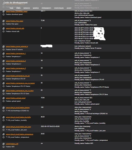

Bonsoir @Christianb233 ,
Si vous avez bien les entités ci-dessous ainsi que les attributs associés tout devrait fonctionner sans problème.
Pouvez vous mettre une copie d’écran de vos entités associées à votre freebox?
Voilà les entités filtrés freebox (désolé, il y a des autres entités liés à des automatisations, scripts et lampe que j’ai défini par ailleurs) :
@Christianb233
Vous avez une Freebox POP?
oups une Freebox Delta :sweat_smile:
