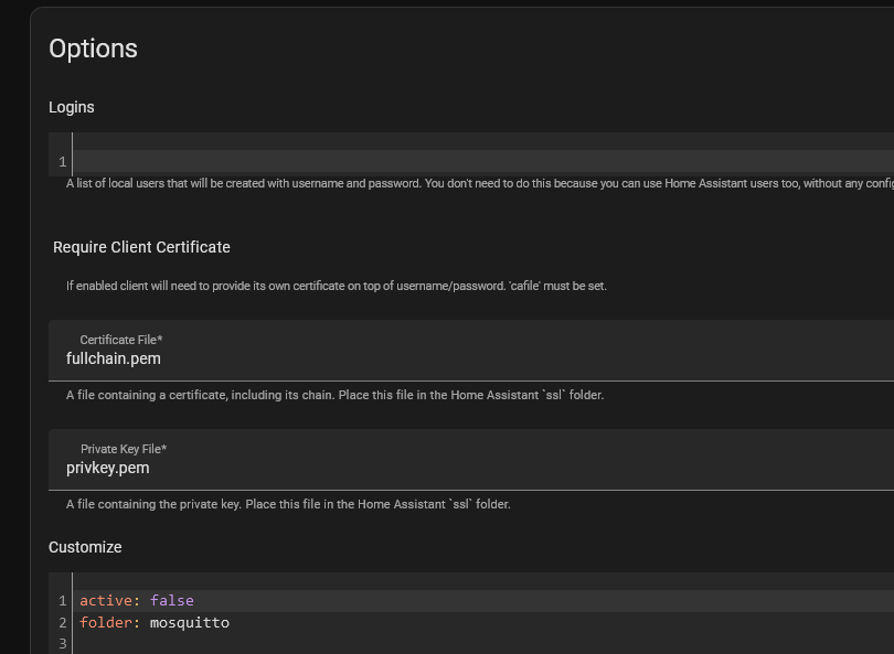

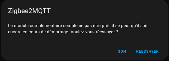

Du coup, j’en profite pour installer MQTT, mais j’ai un message d’erreur:
Pour info:

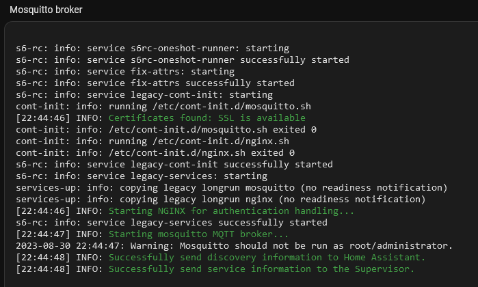

Mosquitto broker:
cont-init: info: running /etc/cont-init.d/mosquitto.sh
[18:13:58] INFO: Certificates found: SSL is available
cont-init: info: /etc/cont-init.d/mosquitto.sh exited 0
cont-init: info: running /etc/cont-init.d/nginx.sh
cont-init: info: /etc/cont-init.d/nginx.sh exited 0
services-up: info: copying legacy longrun mosquitto (no readiness notification)
services-up: info: copying legacy longrun nginx (no readiness notification)
[18:13:58] INFO: Starting NGINX for authentication handling…
[18:13:58] INFO: Starting mosquitto MQTT broker…
2023-08-27 18:13:58: Warning: Mosquitto should not be run as root/administrator.
[18:13:59] INFO: Successfully send discovery information to Home Assistant.
[18:13:59] INFO: Successfully send service information to the Supervisor.

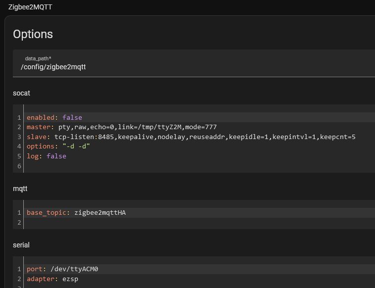

Zigbee2MQTT
[18:19:26] INFO: Preparing to start…
[18:19:26] INFO: Socat not enabled
[18:19:28] INFO: Starting Zigbee2MQTT…
Zigbee2MQTT:info 2023-08-27 18:19:31: Logging to console and directory: ‹ /config/zigbee2mqtt/log/2023-08-27.18-19-31 › filename: log.txt
Zigbee2MQTT:info 2023-08-27 18:19:31: Starting Zigbee2MQTT version 1.32.2 (commit #unknown)
Zigbee2MQTT:info 2023-08-27 18:19:31: Starting zigbee-herdsman (0.17.2)
Zigbee2MQTT:error 2023-08-27 18:19:42: Error while starting zigbee-herdsman
Zigbee2MQTT:error 2023-08-27 18:19:42: Failed to start zigbee
Zigbee2MQTT:error 2023-08-27 18:19:42: Check https://www.zigbee2mqtt.io/guide/installation/20_zigbee2mqtt-fails-to-start.html for possible solutions
Zigbee2MQTT:error 2023-08-27 18:19:42: Exiting…
Zigbee2MQTT:error 2023-08-27 18:19:42: undefined

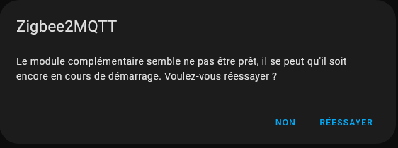

Je ne sais pas trop comment régler le soucis.
Merci pour le coup de main
Merci Giga 77
Comment faire?

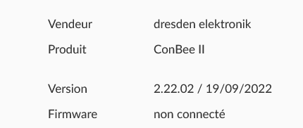

Hello.
J’ai remplacé ma Deconze par une Sonoff v2.
Même problème.
Ma configue:
Materiel
Je ne comprend pas ce qui coince :thinking:
