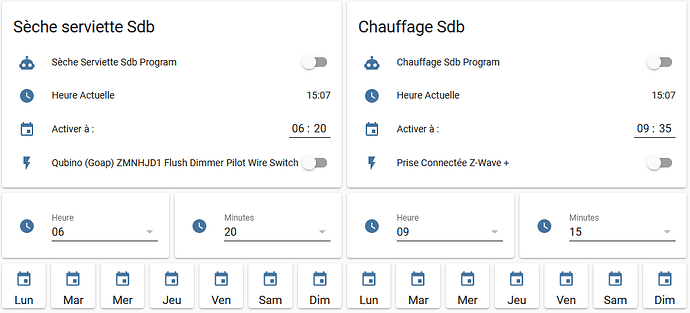

Rappelons que le but était de pouvoir régler les heures du chauffage de la salle de bain et du sèche serviette grâce à une notification actionnable tous les soirs à 20h avec mon mobile ios :

Après si le bouton du jour n’est pas activé, l’automation du chauffage, même si l’heure est bien réglée, ne se fait pas !

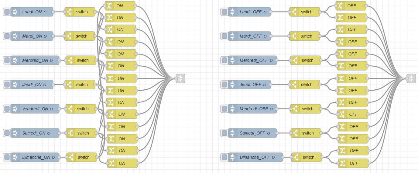

Du coup j’ai activé mes boutons de manière automatique avec node-red via l’API de HA :
https://forum-test.hacf.fr/t/piloter-home-assistant-depuis-node-red-grace-a-lapi-de-ha/2174
[{"id":"d53f1c07.de4fc8","type":"link out","z":"418c41dd.0bfb48","name":"","links":["acca563f.6da948"],"x":595,"y":260,"wires":[]},{"id":"d96d0acf.16e0d","type":"inject","z":"418c41dd.0bfb48","name":"Lundi_ON","props":[{"p":"payload"}],"repeat":"","crontab":"59 19 * * 1","once":false,"onceDelay":0.1,"topic":"","payload":"on","payloadType":"str","x":106,"y":40,"wires":[["bab243.e1f445c"]]},{"id":"d68a344e.aabcc8","type":"inject","z":"418c41dd.0bfb48","name":"Mardi_ON","props":[{"p":"payload"}],"repeat":"","crontab":"59 19 * * 2","once":false,"onceDelay":0.1,"topic":"","payload":"on","payloadType":"str","x":106,"y":120,"wires":[["28e69362.74b584"]]},{"id":"86c01580.3fbb7","type":"inject","z":"418c41dd.0bfb48","name":"Mercredi_ON","props":[{"p":"payload"}],"repeat":"","crontab":"59 19 * * 3","once":false,"onceDelay":0.1,"topic":"","payload":"on","payloadType":"str","x":116,"y":200,"wires":[["6ff1776a.afd11"]]},{"id":"589897ef.8cff5","type":"inject","z":"418c41dd.0bfb48","name":"Jeudi_ON","props":[{"p":"payload"}],"repeat":"","crontab":"59 19 * * 4","once":false,"onceDelay":0.1,"topic":"","payload":"on","payloadType":"str","x":106,"y":280,"wires":[["5ffe40a8.b20be"]]},{"id":"ed96370.2893fc8","type":"inject","z":"418c41dd.0bfb48","name":"Vendredi_ON","props":[{"p":"payload"}],"repeat":"","crontab":"59 19 * * 5","once":false,"onceDelay":0.1,"topic":"","payload":"on","payloadType":"str","x":116,"y":360,"wires":[["c7559832.e7e62"]]},{"id":"9f704e57.328a28","type":"inject","z":"418c41dd.0bfb48","name":"Samedi_ON","props":[{"p":"payload"}],"repeat":"","crontab":"59 19 * * 6","once":false,"onceDelay":0.1,"topic":"","payload":"on","payloadType":"str","x":116,"y":440,"wires":[["8f518a3d.d25eb8"]]},{"id":"18acc323.4fdf25","type":"inject","z":"418c41dd.0bfb48","name":"Dimanche_ON","props":[{"p":"payload"}],"repeat":"","crontab":"59 19 * * 0","once":false,"onceDelay":0.1,"topic":"","payload":"on","payloadType":"str","x":116,"y":520,"wires":[["6e275598.57890c"]]},{"id":"9d7bcfe2.89e23","type":"change","z":"418c41dd.0bfb48","name":"ON","rules":[{"t":"set","p":"payload","pt":"msg","to":"{\"entity_id\":\"input_boolean.wakeweekday_mon_1\"}","tot":"str"},{"t":"set","p":"query.device_type","pt":"msg","to":"input_boolean","tot":"str"},{"t":"set","p":"query.service","pt":"msg","to":"turn_on","tot":"str"}],"action":"","property":"","from":"","to":"","reg":false,"x":396,"y":20,"wires":[["d53f1c07.de4fc8"]]},{"id":"355c22ef.8e24ae","type":"change","z":"418c41dd.0bfb48","name":"ON","rules":[{"t":"set","p":"payload","pt":"msg","to":"{\"entity_id\":\"input_boolean.wakeweekday_mon_2\"}","tot":"str"},{"t":"set","p":"query.device_type","pt":"msg","to":"input_boolean","tot":"str"},{"t":"set","p":"query.service","pt":"msg","to":"turn_on","tot":"str"}],"action":"","property":"","from":"","to":"","reg":false,"x":397,"y":59,"wires":[["d53f1c07.de4fc8"]]},{"id":"89a55534.5e0b1","type":"change","z":"418c41dd.0bfb48","name":"ON","rules":[{"t":"set","p":"payload","pt":"msg","to":"{\"entity_id\":\"input_boolean.wakeweekday_tue_1\"}","tot":"str"},{"t":"set","p":"query.device_type","pt":"msg","to":"input_boolean","tot":"str"},{"t":"set","p":"query.service","pt":"msg","to":"turn_on","tot":"str"}],"action":"","property":"","from":"","to":"","reg":false,"x":398,"y":98,"wires":[["d53f1c07.de4fc8"]]},{"id":"ed05d9b7.ff101","type":"change","z":"418c41dd.0bfb48","name":"ON","rules":[{"t":"set","p":"payload","pt":"msg","to":"{\"entity_id\":\"input_boolean.wakeweekday_tue_2\"}","tot":"str"},{"t":"set","p":"query.device_type","pt":"msg","to":"input_boolean","tot":"str"},{"t":"set","p":"query.service","pt":"msg","to":"turn_on","tot":"str"}],"action":"","property":"","from":"","to":"","reg":false,"x":399,"y":139,"wires":[["d53f1c07.de4fc8"]]},{"id":"fe930fcd.dda888","type":"change","z":"418c41dd.0bfb48","name":"ON","rules":[{"t":"set","p":"payload","pt":"msg","to":"{\"entity_id\":\"input_boolean.wakeweekday_wed_1\"}","tot":"str"},{"t":"set","p":"query.device_type","pt":"msg","to":"input_boolean","tot":"str"},{"t":"set","p":"query.service","pt":"msg","to":"turn_on","tot":"str"}],"action":"","property":"","from":"","to":"","reg":false,"x":399,"y":179,"wires":[["d53f1c07.de4fc8"]]},{"id":"35c434a5.6806d4","type":"change","z":"418c41dd.0bfb48","name":"ON","rules":[{"t":"set","p":"payload","pt":"msg","to":"{\"entity_id\":\"{\"entity_id\":\"input_boolean.wakeweekday_wed_2\"}\"}","tot":"str"},{"t":"set","p":"query.device_type","pt":"msg","to":"input_boolean","tot":"str"},{"t":"set","p":"query.service","pt":"msg","to":"turn_on","tot":"str"}],"action":"","property":"","from":"","to":"","reg":false,"x":400,"y":218,"wires":[["d53f1c07.de4fc8"]]},{"id":"622320a5.2f7508","type":"change","z":"418c41dd.0bfb48","name":"ON","rules":[{"t":"set","p":"payload","pt":"msg","to":"{\"entity_id\":\"input_boolean.wakeweekday_thu_1\"}","tot":"str"},{"t":"set","p":"query.device_type","pt":"msg","to":"input_boolean","tot":"str"},{"t":"set","p":"query.service","pt":"msg","to":"turn_on","tot":"str"}],"action":"","property":"","from":"","to":"","reg":false,"x":400,"y":260,"wires":[["d53f1c07.de4fc8"]]},{"id":"5cd880eb.713ef8","type":"change","z":"418c41dd.0bfb48","name":"ON","rules":[{"t":"set","p":"payload","pt":"msg","to":"{\"entity_id\":\"input_boolean.wakeweekday_thu_2\"}","tot":"str"},{"t":"set","p":"query.device_type","pt":"msg","to":"input_boolean","tot":"str"},{"t":"set","p":"query.service","pt":"msg","to":"turn_on","tot":"str"}],"action":"","property":"","from":"","to":"","reg":false,"x":400,"y":300,"wires":[["d53f1c07.de4fc8"]]},{"id":"495103bf.06890c","type":"change","z":"418c41dd.0bfb48","name":"ON","rules":[{"t":"set","p":"payload","pt":"msg","to":"{\"entity_id\":\"input_boolean.wakeweekday_fri_1\"}","tot":"str"},{"t":"set","p":"query.device_type","pt":"msg","to":"input_boolean","tot":"str"},{"t":"set","p":"query.service","pt":"msg","to":"turn_on","tot":"str"}],"action":"","property":"","from":"","to":"","reg":false,"x":401,"y":339,"wires":[["d53f1c07.de4fc8"]]},{"id":"8873d52b.b80228","type":"change","z":"418c41dd.0bfb48","name":"ON","rules":[{"t":"set","p":"payload","pt":"msg","to":"{\"entity_id\":\"input_boolean.wakeweekday_fri_2\"}","tot":"str"},{"t":"set","p":"query.device_type","pt":"msg","to":"input_boolean","tot":"str"},{"t":"set","p":"query.service","pt":"msg","to":"turn_on","tot":"str"}],"action":"","property":"","from":"","to":"","reg":false,"x":402,"y":378,"wires":[["d53f1c07.de4fc8"]]},{"id":"61ac9a14.3523f4","type":"change","z":"418c41dd.0bfb48","name":"ON","rules":[{"t":"set","p":"payload","pt":"msg","to":"{\"entity_id\":\"input_boolean.wakeweekday_sat_1\"}","tot":"str"},{"t":"set","p":"query.device_type","pt":"msg","to":"input_boolean","tot":"str"},{"t":"set","p":"query.service","pt":"msg","to":"turn_on","tot":"str"}],"action":"","property":"","from":"","to":"","reg":false,"x":403,"y":419,"wires":[["d53f1c07.de4fc8"]]},{"id":"85ab2396.899ab","type":"change","z":"418c41dd.0bfb48","name":"ON","rules":[{"t":"set","p":"payload","pt":"msg","to":"{\"entity_id\":\"input_boolean.wakeweekday_sat_2\"}","tot":"str"},{"t":"set","p":"query.device_type","pt":"msg","to":"input_boolean","tot":"str"},{"t":"set","p":"query.service","pt":"msg","to":"turn_on","tot":"str"}],"action":"","property":"","from":"","to":"","reg":false,"x":403,"y":459,"wires":[["d53f1c07.de4fc8"]]},{"id":"2ac08e87.17ebb2","type":"change","z":"418c41dd.0bfb48","name":"ON","rules":[{"t":"set","p":"payload","pt":"msg","to":"{\"entity_id\":\"input_boolean.wakeweekday_sun_1\"}","tot":"str"},{"t":"set","p":"query.device_type","pt":"msg","to":"input_boolean","tot":"str"},{"t":"set","p":"query.service","pt":"msg","to":"turn_on","tot":"str"}],"action":"","property":"","from":"","to":"","reg":false,"x":404,"y":498,"wires":[["d53f1c07.de4fc8"]]},{"id":"7279b0d4.7444a","type":"change","z":"418c41dd.0bfb48","name":"ON","rules":[{"t":"set","p":"payload","pt":"msg","to":"{\"entity_id\":\"input_boolean.wakeweekday_sun_2\"}","tot":"str"},{"t":"set","p":"query.device_type","pt":"msg","to":"input_boolean","tot":"str"},{"t":"set","p":"query.service","pt":"msg","to":"turn_on","tot":"str"}],"action":"","property":"","from":"","to":"","reg":false,"x":404,"y":540,"wires":[["d53f1c07.de4fc8"]]},{"id":"5ffe40a8.b20be","type":"switch","z":"418c41dd.0bfb48","name":"","property":"payload","propertyType":"msg","rules":[{"t":"eq","v":"on","vt":"str"}],"checkall":"true","repair":false,"outputs":1,"x":264,"y":280,"wires":[["495103bf.06890c","8873d52b.b80228"]]},{"id":"bab243.e1f445c","type":"switch","z":"418c41dd.0bfb48","name":"","property":"payload","propertyType":"msg","rules":[{"t":"eq","v":"on","vt":"str"}],"checkall":"true","repair":false,"outputs":1,"x":264,"y":40,"wires":[["89a55534.5e0b1","ed05d9b7.ff101"]]},{"id":"28e69362.74b584","type":"switch","z":"418c41dd.0bfb48","name":"","property":"payload","propertyType":"msg","rules":[{"t":"eq","v":"on","vt":"str"}],"checkall":"true","repair":false,"outputs":1,"x":263,"y":120,"wires":[["fe930fcd.dda888","35c434a5.6806d4"]]},{"id":"6ff1776a.afd11","type":"switch","z":"418c41dd.0bfb48","name":"","property":"payload","propertyType":"msg","rules":[{"t":"eq","v":"on","vt":"str"}],"checkall":"true","repair":false,"outputs":1,"x":267,"y":200,"wires":[["622320a5.2f7508","5cd880eb.713ef8"]]},{"id":"c7559832.e7e62","type":"switch","z":"418c41dd.0bfb48","name":"","property":"payload","propertyType":"msg","rules":[{"t":"eq","v":"on","vt":"str"}],"checkall":"true","repair":false,"outputs":1,"x":267,"y":360,"wires":[["61ac9a14.3523f4","85ab2396.899ab"]]},{"id":"8f518a3d.d25eb8","type":"switch","z":"418c41dd.0bfb48","name":"","property":"payload","propertyType":"msg","rules":[{"t":"eq","v":"on","vt":"str"}],"checkall":"true","repair":false,"outputs":1,"x":268,"y":440,"wires":[["2ac08e87.17ebb2","7279b0d4.7444a"]]},{"id":"6e275598.57890c","type":"switch","z":"418c41dd.0bfb48","name":"","property":"payload","propertyType":"msg","rules":[{"t":"eq","v":"on","vt":"str"}],"checkall":"true","repair":false,"outputs":1,"x":270,"y":520,"wires":[["9d7bcfe2.89e23","355c22ef.8e24ae"]]},{"id":"328974df.a38db4","type":"inject","z":"418c41dd.0bfb48","name":"Lundi_OFF","props":[{"p":"payload"}],"repeat":"","crontab":"00 12 * * 1","once":false,"onceDelay":0.1,"topic":"","payload":"off","payloadType":"str","x":822,"y":40,"wires":[["6d396474.3ca824"]]},{"id":"7c273ca3.0d202c","type":"inject","z":"418c41dd.0bfb48","name":"Mardi_OFF","props":[{"p":"payload"}],"repeat":"","crontab":"00 12 * * 2","once":false,"onceDelay":0.1,"topic":"","payload":"off","payloadType":"str","x":822,"y":120,"wires":[["792b302f.0a5e5"]]},{"id":"dc105b50.39c658","type":"inject","z":"418c41dd.0bfb48","name":"Mercredi_OFF","props":[{"p":"payload"}],"repeat":"","crontab":"00 12 * * 3","once":false,"onceDelay":0.1,"topic":"","payload":"off","payloadType":"str","x":832,"y":200,"wires":[["460fdd7a.c8902c"]]},{"id":"d01036a8.ae9bd8","type":"inject","z":"418c41dd.0bfb48","name":"Jeudi_OFF","props":[{"p":"payload"}],"repeat":"","crontab":"00 12 * * 4","once":false,"onceDelay":0.1,"topic":"","payload":"off","payloadType":"str","x":822,"y":280,"wires":[["43bc8866.ab55b"]]},{"id":"a8bf2a50.081c","type":"inject","z":"418c41dd.0bfb48","name":"Vendredi_OFF","props":[{"p":"payload"}],"repeat":"","crontab":"00 12 * * 5","once":false,"onceDelay":0.1,"topic":"","payload":"off","payloadType":"str","x":832,"y":360,"wires":[["43a44ac7.da248c"]]},{"id":"2e74459f.c60c6a","type":"inject","z":"418c41dd.0bfb48","name":"Samedi_OFF","props":[{"p":"payload"}],"repeat":"","crontab":"00 12 * * 6","once":false,"onceDelay":0.1,"topic":"","payload":"off","payloadType":"str","x":832,"y":440,"wires":[["bf6fde25.29a1a8"]]},{"id":"7db0ce2b.82fac8","type":"inject","z":"418c41dd.0bfb48","name":"Dimanche_OFF","props":[{"p":"payload"}],"repeat":"","crontab":"00 12 * * 0","once":false,"onceDelay":0.1,"topic":"","payload":"off","payloadType":"str","x":842,"y":520,"wires":[["98144233.b3e678"]]},{"id":"43bc8866.ab55b","type":"switch","z":"418c41dd.0bfb48","name":"","property":"payload","propertyType":"msg","rules":[{"t":"eq","v":"off","vt":"str"}],"checkall":"true","repair":false,"outputs":1,"x":1004,"y":280,"wires":[["78ff9372.091db4","78f9f50f.3382f4"]]},{"id":"6d396474.3ca824","type":"switch","z":"418c41dd.0bfb48","name":"","property":"payload","propertyType":"msg","rules":[{"t":"eq","v":"off","vt":"str"}],"checkall":"true","repair":false,"outputs":1,"x":1004,"y":40,"wires":[["3123c0c.96707c","fc62355d.367f48"]]},{"id":"792b302f.0a5e5","type":"switch","z":"418c41dd.0bfb48","name":"","property":"payload","propertyType":"msg","rules":[{"t":"eq","v":"off","vt":"str"}],"checkall":"true","repair":false,"outputs":1,"x":1003,"y":120,"wires":[["f3819a19.3e99","a7aef29d.4b3428"]]},{"id":"460fdd7a.c8902c","type":"switch","z":"418c41dd.0bfb48","name":"","property":"payload","propertyType":"msg","rules":[{"t":"eq","v":"off","vt":"str"}],"checkall":"true","repair":false,"outputs":1,"x":1007,"y":200,"wires":[["e3526734.7ec638","b2ff7b61.9ee768"]]},{"id":"43a44ac7.da248c","type":"switch","z":"418c41dd.0bfb48","name":"","property":"payload","propertyType":"msg","rules":[{"t":"eq","v":"off","vt":"str"}],"checkall":"true","repair":false,"outputs":1,"x":1007,"y":360,"wires":[["b7cdf157.e2db6","c665c2d5.8b75a"]]},{"id":"bf6fde25.29a1a8","type":"switch","z":"418c41dd.0bfb48","name":"","property":"payload","propertyType":"msg","rules":[{"t":"eq","v":"off","vt":"str"}],"checkall":"true","repair":false,"outputs":1,"x":1008,"y":440,"wires":[["e4d599ff.e48c68","b442e1d3.b75148"]]},{"id":"98144233.b3e678","type":"switch","z":"418c41dd.0bfb48","name":"","property":"payload","propertyType":"msg","rules":[{"t":"eq","v":"off","vt":"str"}],"checkall":"true","repair":false,"outputs":1,"x":1010,"y":520,"wires":[["cfc43e17.d82508","d096f367.07145"]]},{"id":"a049ab2c.3c563","type":"link out","z":"418c41dd.0bfb48","name":"","links":["acca563f.6da948"],"x":1355,"y":260,"wires":[]},{"id":"3123c0c.96707c","type":"change","z":"418c41dd.0bfb48","name":"OFF","rules":[{"t":"set","p":"payload","pt":"msg","to":"{\"entity_id\":\"input_boolean.wakeweekday_mon_1\"}","tot":"str"},{"t":"set","p":"query.device_type","pt":"msg","to":"input_boolean","tot":"str"},{"t":"set","p":"query.service","pt":"msg","to":"turn_off","tot":"str"}],"action":"","property":"","from":"","to":"","reg":false,"x":1156,"y":20,"wires":[["a049ab2c.3c563"]]},{"id":"fc62355d.367f48","type":"change","z":"418c41dd.0bfb48","name":"OFF","rules":[{"t":"set","p":"payload","pt":"msg","to":"{\"entity_id\":\"input_boolean.wakeweekday_mon_2\"}","tot":"str"},{"t":"set","p":"query.device_type","pt":"msg","to":"input_boolean","tot":"str"},{"t":"set","p":"query.service","pt":"msg","to":"turn_off","tot":"str"}],"action":"","property":"","from":"","to":"","reg":false,"x":1157,"y":59,"wires":[["a049ab2c.3c563"]]},{"id":"f3819a19.3e99","type":"change","z":"418c41dd.0bfb48","name":"OFF","rules":[{"t":"set","p":"payload","pt":"msg","to":"{\"entity_id\":\"input_boolean.wakeweekday_tue_1\"}","tot":"str"},{"t":"set","p":"query.device_type","pt":"msg","to":"input_boolean","tot":"str"},{"t":"set","p":"query.service","pt":"msg","to":"turn_off","tot":"str"}],"action":"","property":"","from":"","to":"","reg":false,"x":1158,"y":98,"wires":[["a049ab2c.3c563"]]},{"id":"a7aef29d.4b3428","type":"change","z":"418c41dd.0bfb48","name":"OFF","rules":[{"t":"set","p":"payload","pt":"msg","to":"{\"entity_id\":\"input_boolean.wakeweekday_tue_2\"}","tot":"str"},{"t":"set","p":"query.device_type","pt":"msg","to":"input_boolean","tot":"str"},{"t":"set","p":"query.service","pt":"msg","to":"turn_off","tot":"str"}],"action":"","property":"","from":"","to":"","reg":false,"x":1159,"y":139,"wires":[["a049ab2c.3c563"]]},{"id":"e3526734.7ec638","type":"change","z":"418c41dd.0bfb48","name":"OFF","rules":[{"t":"set","p":"payload","pt":"msg","to":"{\"entity_id\":\"input_boolean.wakeweekday_wed_1\"}","tot":"str"},{"t":"set","p":"query.device_type","pt":"msg","to":"input_boolean","tot":"str"},{"t":"set","p":"query.service","pt":"msg","to":"turn_off","tot":"str"}],"action":"","property":"","from":"","to":"","reg":false,"x":1159,"y":179,"wires":[["a049ab2c.3c563"]]},{"id":"b2ff7b61.9ee768","type":"change","z":"418c41dd.0bfb48","name":"OFF","rules":[{"t":"set","p":"payload","pt":"msg","to":"{\"entity_id\":\"{\"entity_id\":\"input_boolean.wakeweekday_wed_2\"}\"}","tot":"str"},{"t":"set","p":"query.device_type","pt":"msg","to":"input_boolean","tot":"str"},{"t":"set","p":"query.service","pt":"msg","to":"turn_off","tot":"str"}],"action":"","property":"","from":"","to":"","reg":false,"x":1160,"y":218,"wires":[["a049ab2c.3c563"]]},{"id":"78ff9372.091db4","type":"change","z":"418c41dd.0bfb48","name":"OFF","rules":[{"t":"set","p":"payload","pt":"msg","to":"{\"entity_id\":\"input_boolean.wakeweekday_thu_1\"}","tot":"str"},{"t":"set","p":"query.device_type","pt":"msg","to":"input_boolean","tot":"str"},{"t":"set","p":"query.service","pt":"msg","to":"turn_off","tot":"str"}],"action":"","property":"","from":"","to":"","reg":false,"x":1160,"y":260,"wires":[["a049ab2c.3c563"]]},{"id":"78f9f50f.3382f4","type":"change","z":"418c41dd.0bfb48","name":"OFF","rules":[{"t":"set","p":"payload","pt":"msg","to":"{\"entity_id\":\"input_boolean.wakeweekday_thu_2\"}","tot":"str"},{"t":"set","p":"query.device_type","pt":"msg","to":"input_boolean","tot":"str"},{"t":"set","p":"query.service","pt":"msg","to":"turn_off","tot":"str"}],"action":"","property":"","from":"","to":"","reg":false,"x":1160,"y":300,"wires":[["a049ab2c.3c563"]]},{"id":"b7cdf157.e2db6","type":"change","z":"418c41dd.0bfb48","name":"OFF","rules":[{"t":"set","p":"payload","pt":"msg","to":"{\"entity_id\":\"input_boolean.wakeweekday_fri_1\"}","tot":"str"},{"t":"set","p":"query.device_type","pt":"msg","to":"input_boolean","tot":"str"},{"t":"set","p":"query.service","pt":"msg","to":"turn_off","tot":"str"}],"action":"","property":"","from":"","to":"","reg":false,"x":1161,"y":339,"wires":[["a049ab2c.3c563"]]},{"id":"c665c2d5.8b75a","type":"change","z":"418c41dd.0bfb48","name":"OFF","rules":[{"t":"set","p":"payload","pt":"msg","to":"{\"entity_id\":\"input_boolean.wakeweekday_fri_2\"}","tot":"str"},{"t":"set","p":"query.device_type","pt":"msg","to":"input_boolean","tot":"str"},{"t":"set","p":"query.service","pt":"msg","to":"turn_off","tot":"str"}],"action":"","property":"","from":"","to":"","reg":false,"x":1162,"y":378,"wires":[["a049ab2c.3c563"]]},{"id":"e4d599ff.e48c68","type":"change","z":"418c41dd.0bfb48","name":"OFF","rules":[{"t":"set","p":"payload","pt":"msg","to":"{\"entity_id\":\"input_boolean.wakeweekday_sat_1\"}","tot":"str"},{"t":"set","p":"query.device_type","pt":"msg","to":"input_boolean","tot":"str"},{"t":"set","p":"query.service","pt":"msg","to":"turn_off","tot":"str"}],"action":"","property":"","from":"","to":"","reg":false,"x":1163,"y":419,"wires":[["a049ab2c.3c563"]]},{"id":"b442e1d3.b75148","type":"change","z":"418c41dd.0bfb48","name":"OFF","rules":[{"t":"set","p":"payload","pt":"msg","to":"{\"entity_id\":\"input_boolean.wakeweekday_sat_2\"}","tot":"str"},{"t":"set","p":"query.device_type","pt":"msg","to":"input_boolean","tot":"str"},{"t":"set","p":"query.service","pt":"msg","to":"turn_off","tot":"str"}],"action":"","property":"","from":"","to":"","reg":false,"x":1163,"y":459,"wires":[["a049ab2c.3c563"]]},{"id":"cfc43e17.d82508","type":"change","z":"418c41dd.0bfb48","name":"OFF","rules":[{"t":"set","p":"payload","pt":"msg","to":"{\"entity_id\":\"input_boolean.wakeweekday_sun_1\"}","tot":"str"},{"t":"set","p":"query.device_type","pt":"msg","to":"input_boolean","tot":"str"},{"t":"set","p":"query.service","pt":"msg","to":"turn_off","tot":"str"}],"action":"","property":"","from":"","to":"","reg":false,"x":1164,"y":498,"wires":[["a049ab2c.3c563"]]},{"id":"d096f367.07145","type":"change","z":"418c41dd.0bfb48","name":"OFF","rules":[{"t":"set","p":"payload","pt":"msg","to":"{\"entity_id\":\"input_boolean.wakeweekday_sun_2\"}","tot":"str"},{"t":"set","p":"query.device_type","pt":"msg","to":"input_boolean","tot":"str"},{"t":"set","p":"query.service","pt":"msg","to":"turn_off","tot":"str"}],"action":"","property":"","from":"","to":"","reg":false,"x":1164,"y":540,"wires":[["a049ab2c.3c563"]]}]
