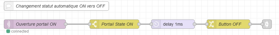

Pour ça j’utilise pour ma part une automatisation (automation) :
Le déclencheur se fait sur l’état on du switch, on attends 500ms puis on passe le switch à off

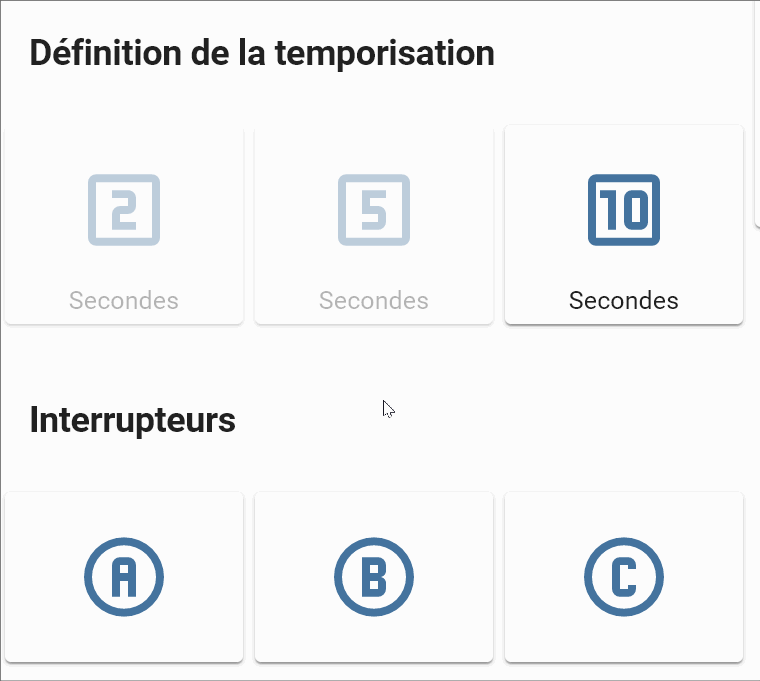

Et voici un aperçu du résultat dans Lovelace (peut être les boutons bascule que tu voulais ?) :
switch_désactivation_automatique
Code de la carte (utilisation de card-mod)

Hello @Captain
Merci pour cette solution alternative.
Pour ma part je cherchais effectivement à « convertir » un bouton classique en bouton poussoir qui revenait à l’état d’origine.
Je suis passé par node-red et MQTT avec l’API de HA pour réaliser ça :
        "id": "7bcfb492.596d6c",
        "type": "mqtt in",
        "z": "12339730.c71e41",
        "name": "Ouverture portail ON",
        "topic": "homeassistant/switch/fibaro_system_unknown_type_0204_id_1000_switch/state",
        "qos": "2",
        "datatype": "auto",
        "broker": "d32f05f2.4d0038",
        "x": 120,
        "y": 80,
        "wires": [
                "b82219b.9f65a68"
        "id": "b82219b.9f65a68",
        "type": "switch",
        "name": "Portail State ON",
        "property": "payload",
        "propertyType": "msg",
        "rules": [
                "t": "eq",
                "v": "on",
                "vt": "str"
        "checkall": "true",
        "repair": false,
        "outputs": 1,
        "x": 378,
        "y": 80,
        "wires": [
                "db5cbdbc.ad11c"
        "id": "db5cbdbc.ad11c",
        "type": "delay",
        "name": "",
        "pauseType": "delay",
        "timeout": "1",
        "timeoutUnits": "milliseconds",
        "rate": "1",
        "nbRateUnits": "1",
        "rateUnits": "second",
        "randomFirst": "1",
        "randomLast": "5",
        "randomUnits": "seconds",
        "drop": false,
        "x": 568,
        "y": 80,
        "wires": [
                "184d677f.7b10b1"
        "id": "184d677f.7b10b1",
        "type": "change",
        "name": "Button OFF",
        "rules": [
                "t": "set",
                "p": "payload",
                "pt": "msg",
                "to": "{\"entity_id\":\"switch.fibaro_system_unknown_type_0204_id_1000_switch\"}",
                "tot": "str"
                "t": "set",
                "p": "query.device_type",
                "pt": "msg",
                "to": "switch",
                "tot": "str"
                "t": "set",
                "p": "query.service",
                "pt": "msg",
                "to": "turn_off",
                "tot": "str"
        "action": "",
        "property": "",
        "from": "",
        "to": "",
        "reg": false,
        "x": 748,
        "y": 80,
        "wires": [
                "d3726856.ed567"
        "id": "d3726856.ed567",
        "type": "link out",
        "name": "",
        "links": [
            "acca563f.6da948"
        "x": 873,
        "y": 80,
        "wires": []
        "id": "d32f05f2.4d0038",
        "type": "mqtt-broker",
        "name": "MQTT BROKER",
        "broker": "192.168.X.X",
        "port": "1883",
        "clientid": "",
        "usetls": false,
        "compatmode": false,
        "keepalive": "60",
        "cleansession": true,
        "birthTopic": "",
        "birthQos": "0",
        "birthPayload": "",
        "closeTopic": "",
        "closeQos": "0",
        "closePayload": "",
        "willTopic": "",
        "willQos": "0",
        "willPayload": ""
Et ça fonctionne plutôt bien !
