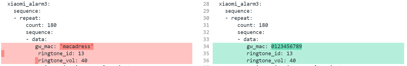

        - data:
           gw_mac: 'macadress'
            ringtone_id: 13
            ringtone_vol: 40
          service: xiaomi_aqara.play_ringtone

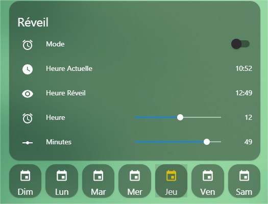

Et le code pour la carte lovelace:
  - entities:
      - entity: input_boolean.wakestatus_1
      - entity: sensor.time
      - entity: sensor.wake_time_1
      - entity: input_number.wakehour_1
      - entity: input_number.wakeminutes_1
    show_header_toggle: false
    title: Réveil
    type: entities
  - cards:
      - entity: input_boolean.wakeweekday_sun_1
        hold_action:
          action: none
        icon_height: 40px
        show_icon: true
        show_name: true
        tap_action:
          action: toggle
        type: button
      - entity: input_boolean.wakeweekday_mon_1
        hold_action:
          action: none
        icon_height: 40px
        show_icon: true
        show_name: true
        tap_action:
          action: toggle
        type: button
      - entity: input_boolean.wakeweekday_tue_1
        hold_action:
          action: none
        icon_height: 40px
        show_icon: true
        show_name: true
        tap_action:
          action: toggle
        type: button
      - entity: input_boolean.wakeweekday_wed_1
        hold_action:
          action: none
        icon_height: 40px
        show_icon: true
        show_name: true
        tap_action:
          action: toggle
        type: button
      - entity: input_boolean.wakeweekday_thu_1
        hold_action:
          action: none
        icon_height: 40px
        show_icon: true
        show_name: true
        tap_action:
          action: toggle
        type: button
      - entity: input_boolean.wakeweekday_fri_1
        hold_action:
          action: none
        icon_height: 40px
        show_icon: true
        show_name: true
        tap_action:
          action: toggle
        type: button
      - entity: input_boolean.wakeweekday_sat_1
        hold_action:
          action: none
        icon_height: 40px
        show_icon: true
        show_name: true
        tap_action:
          action: toggle
        type: button
    type: horizontal-stack

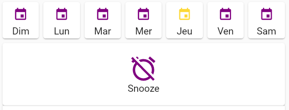

  - type: conditional
    conditions:
      - entity: input_boolean.wakeactivated_1
        state: 'on'
    card:
      type: button
      tap_action:
        action: toggle
      hold_action:
        action: more-info
      show_icon: true
      show_name: true
      show_state: false
      entity: script.alarm_snooze
      icon: 'mdi:alarm-off'
      icon_height: 50px

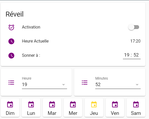

@cob94440, on en parlais hier, voici une autre façon (j’ai conservé tous les noms pour faciliter la comparaison) :
Pour ceux qui comme moi sont plus à l’aise (surtout sur mobile) avec des input_select pour la définition de l’heure :
#Par rapport au post 1 de @cob94440
# sensor.wake_time_1 est remplacé par input_datetime.wake_time_1 pour la définition de l'heure du réveil
# input_number.wakehour_1 est remplacé par input_select.wakehour_1 pour la définition de l'heure
# input_number.wakeminutes_1 est remplacé par input_select.wakeminutes_1 pour la définition des minutes

        - data:
           gw_mac: 0123456789
           ringtone_id: 13
           ringtone_vol: 40

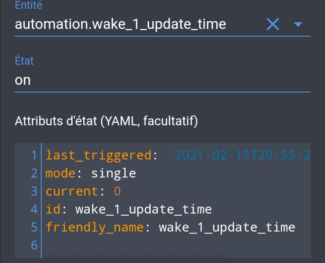

  - id: 'wake_1_update_time' #nouvelle par rapport au post 1
    # Automatisation qui met à jour le input_datetime 'wake_time_1' représentant l'heure du reveil
    # en fonction des input_select représentants les heures et les minutes
    alias: wake_1_update_time
      - platform: state
        entity_id: input_select.wakehour_1
      - platform: state
        entity_id: input_select.wakeminutes_1
    - service: input_datetime.set_datetime
      entity_id: input_datetime.wake_time_1
      data_template:
        time: '{{states("input_select.wakehour_1")}}:{{states("input_select.wakeminutes_1")}}:00'

Ce qui donne côté Lovelace :
code de la carte :
  - entities:
        icon: 'mdi:alarm-check'
      - entity: input_datetime.wake_time_1
        name: 'Sonner à :'
    title: Réveil
    type: entities
  - cards:
      - entities:
          - entity: input_select.wakehour_1
        title: null
        type: entities
      - entities:
          - entity: input_select.wakeminutes_1
        title: null
        type: entities
  - cards:
        hold_action:
          action: none
        icon_height: 40px
        show_icon: true
        show_name: true
        tap_action:
          action: toggle
        type: button
        hold_action:
          action: none
        icon_height: 40px
        show_icon: true
        show_name: true
        tap_action:
          action: toggle
        type: button
        hold_action:
          action: none
        icon_height: 40px
        show_icon: true
        show_name: true
        tap_action:
          action: toggle
        type: button
        hold_action:
          action: none
        icon_height: 40px
        show_icon: true
        show_name: true
        tap_action:
          action: toggle
        type: button
        hold_action:
          action: none
        icon_height: 40px
        show_icon: true
        show_name: true
        tap_action:
          action: toggle
        type: button
        hold_action:
          action: none
        icon_height: 40px
        show_icon: true
        show_name: true
        tap_action:
          action: toggle
        type: button
        hold_action:
          action: none
        icon_height: 40px
        show_icon: true
        show_name: true
        tap_action:
          action: toggle
        type: button
  - card:
      hold_action:
        action: more-info
      icon_height: 50px
      show_icon: true
      show_name: true
      show_state: false
      tap_action:
        action: toggle
      type: button
    conditions:
        state: 'on'
    type: conditional
type: vertical-stack

Ça ne marche toujours pas…
L’automatisation d’update n’est pas déclenché quand je modifie l’heure du reveil sur la carte :
Tu mets bien a jour l’heure à travers les 2 input_select (heure/minute)?
